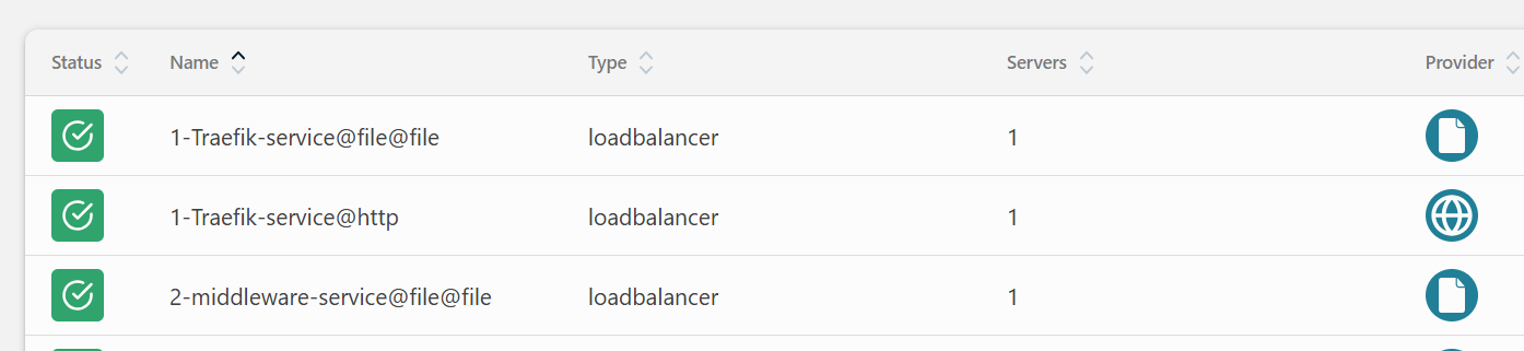

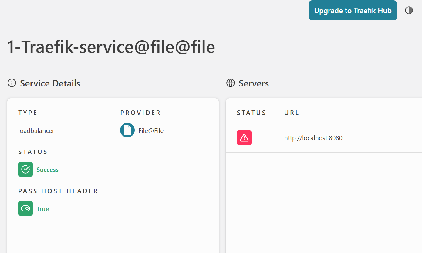

I added the crowdsec bouncer to one resource, traefik dashboard shows the added middleware and no errors.
I added my IP, Step 14. Can see it in the decision list. The IP is not blocked, can access the resource
