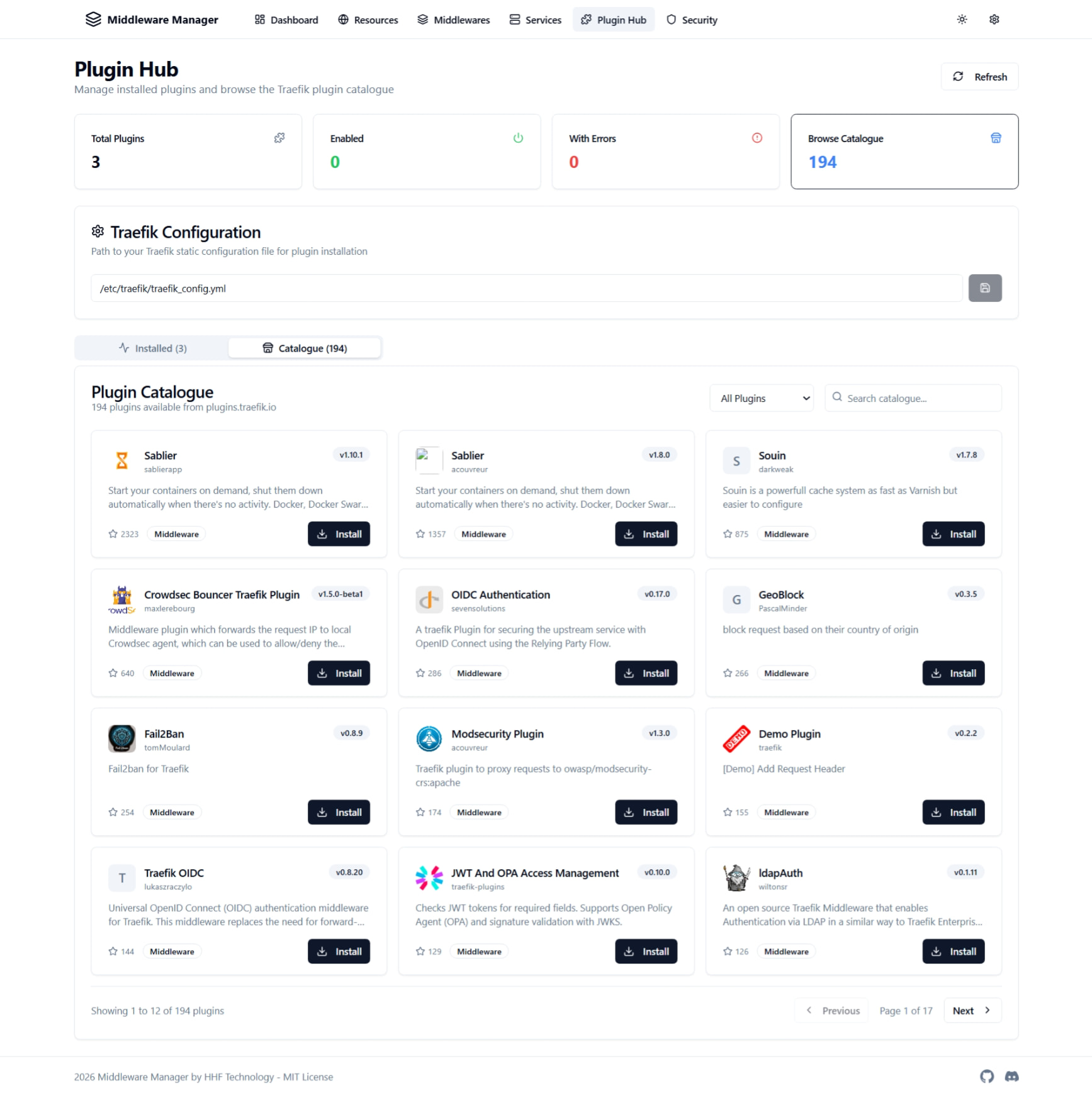

for the last 2 days i try to install crowdsec bouncer plugin but seems that https://raw.githubusercontent.com/hhftechnology/middleware-manager/traefik-int/plugin/plugins.json returns 404 not found .
Try
https://raw.githubusercontent.com/hhftechnology/middleware-manager/refs/heads/main/plugin/plugins.json
I think the traefik-int branch is gone.
I am encountering the same issues and even after changing the original url to this one, I still get the error
Failed to load plugins: Failed to fetch plugins list: External source returned status 404.”
Is there a working solution on this situation?
