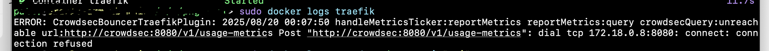

After updating the crowdsec bouncer plugin to 1.4.4 (I was on 1.4.2), I noticed the following entry when I ran docker logs traefik. Any advice on fixing it?

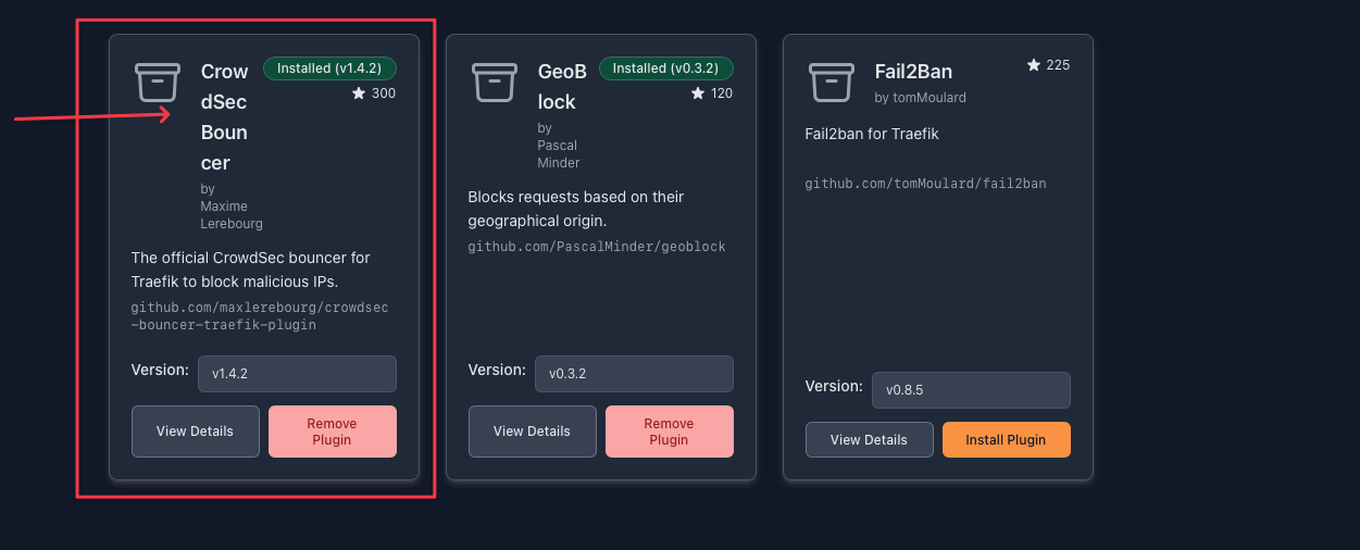

Hi everyone,
I’m struggling to integrate the CrowdSec Bouncer Plugin within Middleware Manager when CrowdSec is installed via the Pangolin installer.

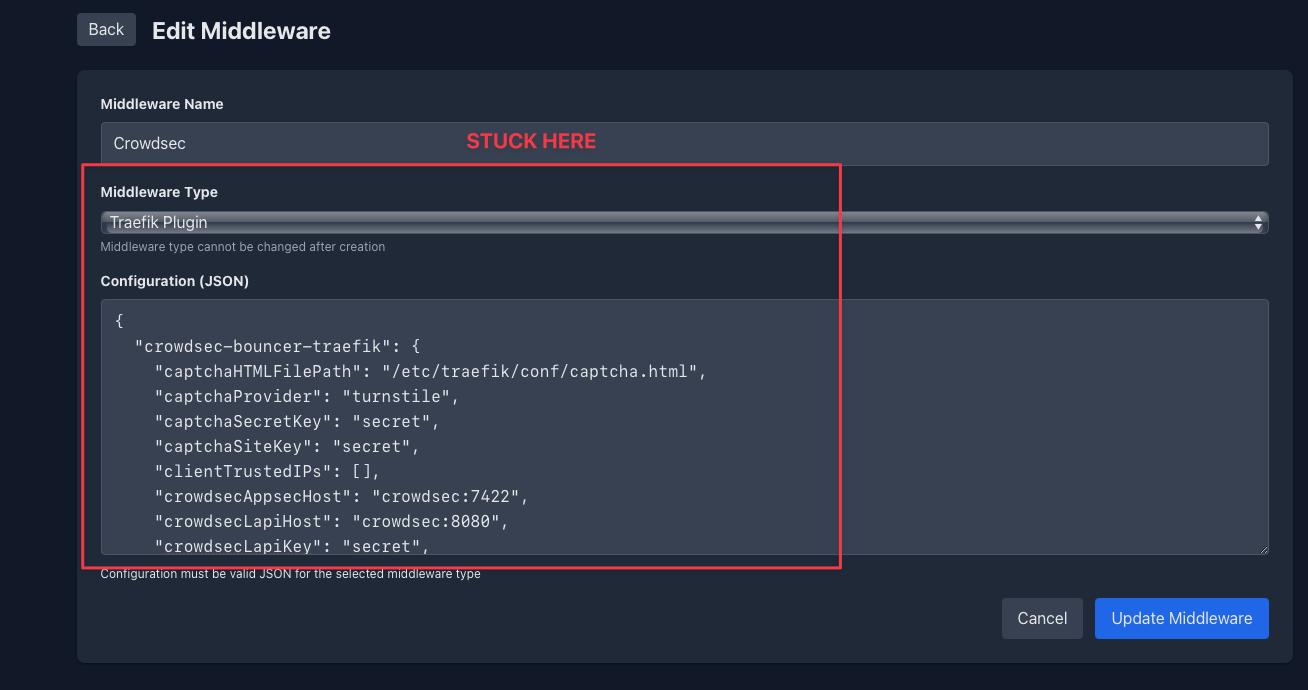

Everything works smoothly up to step 12:
At this step, I hit a wall. Basically Middleware Manager does not detect or list the CrowdSec Bouncer as an available middleware. My goal is to enable selective CAPTCHA protection on certain resources/routes, but I can’t add the CrowdSec Bouncer middleware as described in the guide.
Brief setup & steps taken:
  1. Installed Pangolin (with CrowdSec via docker compose).
  2. Installed crowdsec_manager script
  3. Set up CAPTCHA with the crowdsec_manager script (works directly).
  4. Installed Middleware Manager via docker compose
  5. Unable to make CrowdSec Bouncer middleware work from within Middleware Manager as shown in the step 12
  6. Successfully installed and configured Geoblock middleware manually by creating a new plugin from scratch in the middleware manager with this config.

What I want:
Currently, when applied externally (outside of Middleware Manager), the CrowdSec Bouncer/CAPTCHA protection applies globally to all endpoints—which is not what I need.
My goal is to apply the CrowdSec Bouncer plugin as a middleware on specific routes/resources, protecting just those selected endpoints with a CAPTCHA challenge.
Therefore:
I need to be able to deploy and manage the CrowdSec Bouncer via Middleware Manager, so I can attach it only where needed, rather than having it protect every single route indiscriminately.

Attaching my Traefik static/dynamic configs and relevant other files as reference.
This is the block which I’m struggling with, from the static Traefik.

This is the Traefik dynamic config (Which, by the way, CAPTCHA setup works perfectly, but outside of the MiddlewareManager.)

Then I got stuck here :backhand_index_pointing_down:
Question:
Has anyone managed to get past this specific step (step 12) when using Pangolin with CrowdSec installed via the Pangolin installer, together with Middleware Manager?
In other words: is there a way to successfully add and use the CrowdSec Bouncer as a middleware in Middleware Manager, specifically when CrowdSec comes from the Pangolin installation process, not when installed separately?
Any insight or confirmed working setup in this scenario would be greatly appreciated!
Thank you!
@Mattercoder
This line in your traefik_config.yml
entryPoints:
  web:
    address: :80
  websecure:
    address: :443
    http:
      middlewares:
        - crowdsec@file #this line*****
      tls:
        certResolver: letsencrypt
    transport:
      respondingTimeouts:
        readTimeout: 30m
is adding crowdsec to ALL your inbound web traffic. Remove the crowdsec middleware on the entrypoints and add crowdsec to individual routers as middlewares
Yes, that resolved everything! :white_check_mark:
thank you for your help and clear explanation! @Mattercoder
What I did:
  • I commented this reference section in my traefik_config.yml
    #middlewares:
    # - crowdsec@filefile
  • I also deleted the old CrowdSec configuration from my dynamic_config.yml
  • After that, I added the CrowdSec configuration directly through the Middleware Manager UI using the crowdsec middleware template. The manager updated the resource-overrides.yml automatically.
Here is my CrowdSec config added through the Middleware Manager UI (for reference):
  "crowdsec": {
    "captchaGracePeriodSeconds": 1800,
    "captchaHTMLFilePath": "/etc/traefik/conf/captcha.html",
    "captchaProvider": "turnstile",
    "captchaSecretKey": "XXXXXXXXXXXXXXXXXXXX",
    "captchaSiteKey": "XXXXXXXXXXXXXX",
    "clientTrustedIPs": [
      "x.x.x.x/8",
      "xxx.xx.0.0/12",
      "xxx.xxx.0.0/16",
      "xx.xx.0.0/10"
    "crowdsecAppsecBodyLimit": 10485760,
    "crowdsecAppsecEnabled": true,
    "crowdsecAppsecFailureBlock": true,
    "crowdsecAppsecHost": "crowdsec:7422",
    "crowdsecAppsecUnreachableBlock": true,
    "crowdsecLapiHost": "crowdsec:8080",
    "crowdsecLapiKey": "XXXXXXXXXXXXXXXXXXXXXXXXXXXXXXXX",
    "crowdsecLapiScheme": "http",
    "crowdsecMode": "live",
    "defaultDecisionSeconds": 15,
    "enabled": true,
    "forwardedHeadersTrustedIPs": [
      "0.0.0.0/0"
    "httpTimeoutSeconds": 10,
    "logLevel": "INFO",
    "updateIntervalSeconds": 15,
    "updateMaxFailure": 0
Now everything works as intended! I can easily apply CrowdSec/CAPTCHA protection only to selected routers via Middleware Manager.

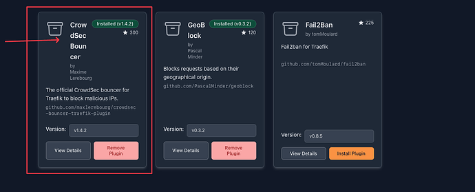

thanks, I did so, the Traefik Dashboard tells me
plugin: unknown plugin type: crowdsec-bouncer-traefik
Make sure the name of the plugin in step 11 when you add the Crowdsec Bouncer Plugin in the Middleware Manager is the same as the plugin name you are using
I did not change the name, after install of the plugin, I found a middleware crowdsec in the middleware section of mm. I did edit this middleware, deleted the original and pasted the text in step 12, and inserted the correct keys, then I did press update middleware.
Check your traefik-config.yml to ensure that the plugin is getting added. If not check that you have specified the correct path to traefik_config.yml. you should see something like
experimental:
    plugins:
        badger:
            moduleName: github.com/fosrl/badger
            version: v1.1.0
        crowdsec-bouncer-traefik:
            moduleName: github.com/maxlerebourg/crowdsec-bouncer-traefik-plugin
            version: v1.4.2
And the rest
Thanks for your patience. My mistake was that I didn’t restart the Traefik container after adding the plugin. Now I only get one error message:
