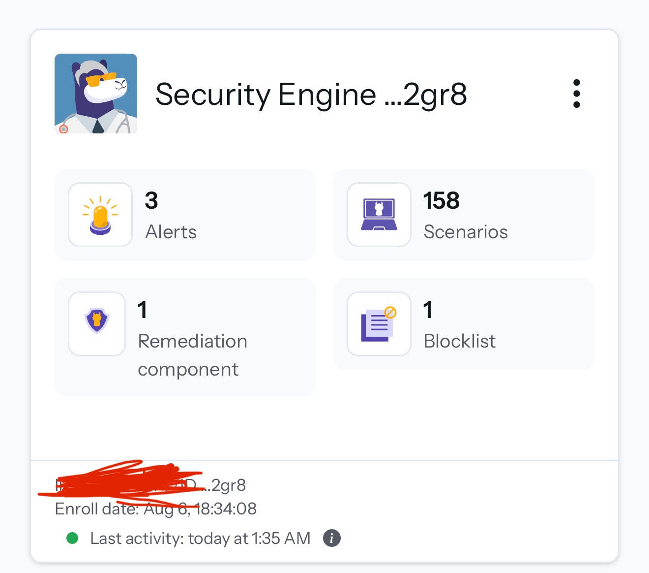

Thanks, I thought I should you see access.log and syslog also. I have accepted the enrollment and see 5 alert since start.

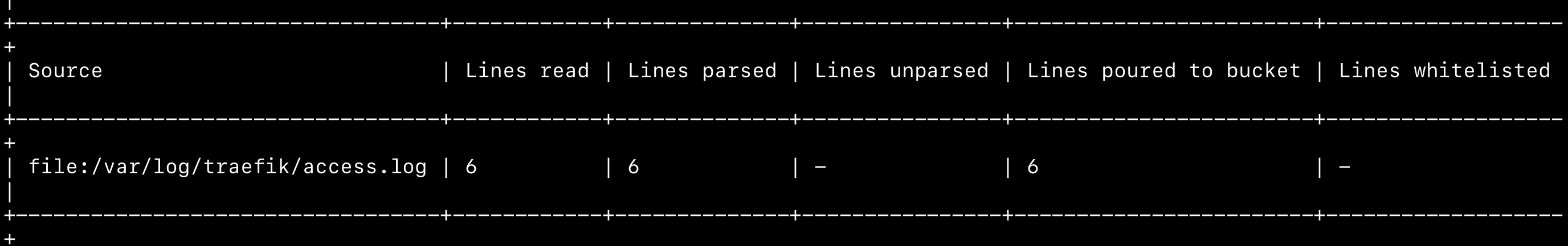

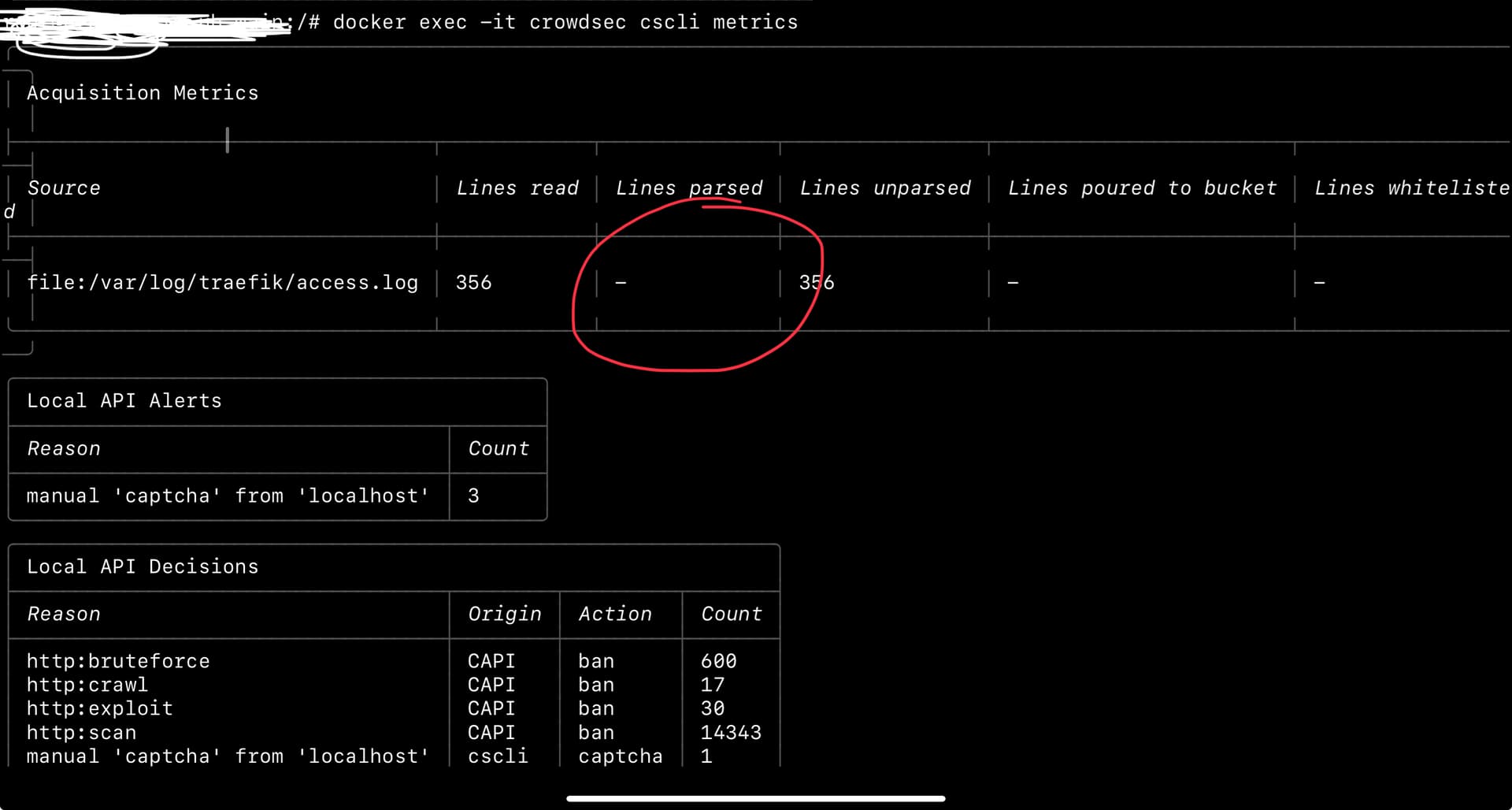

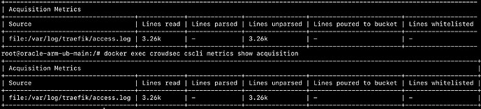

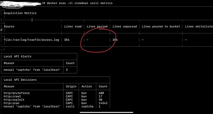

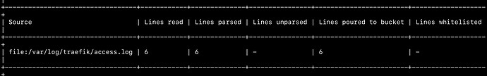

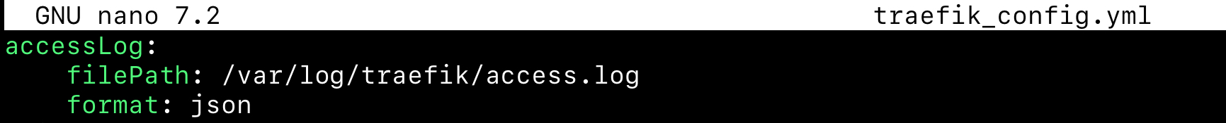

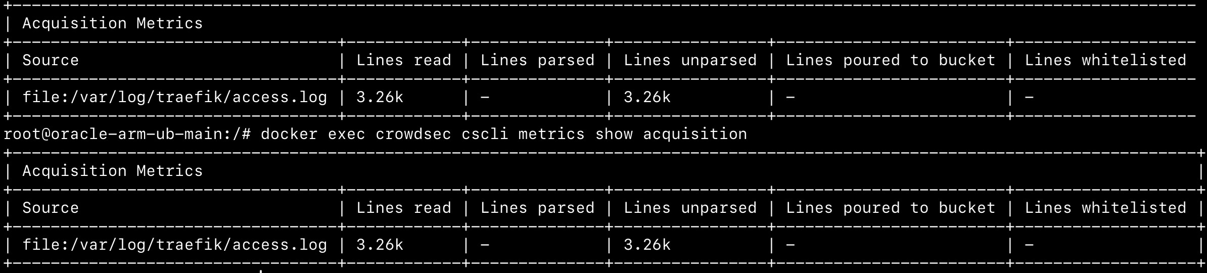

hhf, this guide is fantastic. thank you! however, based on the below, it seems that crowdsec is not correctly parsing my logs. Is that expected?
Have you accepted the enrollment on the crowdsec console?
Absolutely.
Check that your traefik logs are Json format and try this command to see that the logs are being picked up
docker exec crowdsec cscli metrics show acquisition
Try what this poster suggested
Add the crowdsec/linux to the collections
hmmm, interesting. that appears to have worked.
