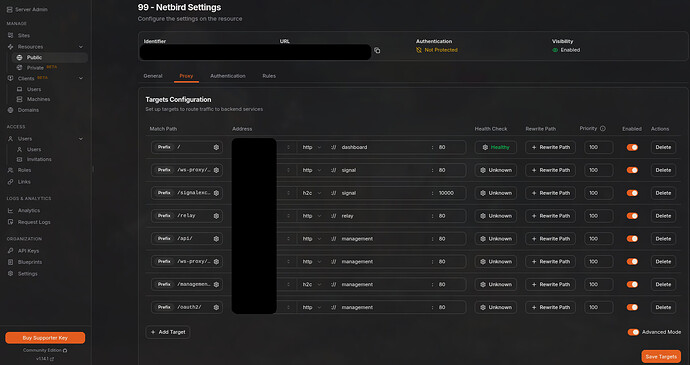

  • Client relay support through Traefik

    - https://nb.p.example.com:443 -http-> dashboard:80
    - https://nb.p.example.com:443/api -http-> management:443
    - https://nb.p.example.com:443/management.ManagementService/ -grpc-> management:443
    - https://nb.p.example.com:443/signalexchange.SignalExchange/ -grpc-> signal:80
    - rels://nb.p.example.com:33080/relay/ -http-> relay:33080

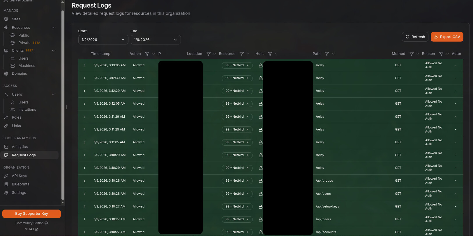

FIXED1 Relay now working
The below address didn’t match the config in Traefik. It should be:
rels://nb.p.example.com:443/relay. Internally 33080 was used, but since Traefik is now handling the traffic, the external details should be exposed.

    "Relay": {
        "Addresses": [
            "rels://nb.p.example.com:443/relay"
        "CredentialsTTL": "24h0m0s",
        "Secret": "RELAY-Secret-Password"

  • I changed all the ports that are 443 and 80 to available ports. Traefik is already running on those ports and I needed to redirect from Traefik to these ports. There probably is a way for Traefik to access the containers without them being exposed. Will look into that.
  • I changed all the volumes to folders that are store in the docker compose folder to allow easier backup and checking files.
  • Lets Encrypt has been disabled since I am using Pangolin that handles the cert management. I talk to all the services internally on HTTP
  • FIXED1: NB_EXPOSED_ADDRESS=rels://nb.p.example.com:33080/relay should match the Traefik and management.json config:
    NB_EXPOSED_ADDRESS=rels://nb.p.example.com:443/relay

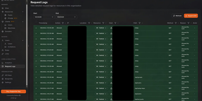

Update:
Successfully installed Netbird under Pangolin through newt in Netbird’s docker compose file. Super Clean. Sign up and login works.
Problem - But unable to connect my devices. Maybe I’ve configured the urls incorrectly
Request Logs shows everything fine. No idea what I missed in copying Caddyfile. Maybe it has something to do with this - Configuration for your reverse-proxy
Btw, here are steps I took to install this -
  1. Install Netbird in ~/netbirdX/ folder with x.example.com pointing to netbird vps
  2. Run docker compose down on the installed netbird stack in netbirdX folder
  3. Copy ~/netbirdX/ folder’s content into ~/netbirdY/ folder with command sudo cp -R ~/netbirdX/ ~/netbirdY/
  4. Applied few tweaks to compose file in netbirdY folder which you can find here
    Changes to note -
    • Added hostnames to each services. Don’t know if that will help
    • Make sure to put your pangolin site credentials in newt service part
    • Make sure to change folder netbirdY in management service part to your folder location.
  5. Change domain names in dashboard.env, management.json and relay.env from x.example.com to y.example.com and run docker compose up -d in netbirdY folder
  6. Create new resource at y.example.com in Pangolin for Netbird with the rules similar to the ones in Caddyfile from netbirdY folder. Check my attachment above, to see how it looks after creation.
  7. Disable Authentication for now (with rules would be good way tho)
    Now when you go to y.example.com, it should work
Let me know if connecting devices works for anyone. That is as far I can get. Or If anyone has some solution, please share. Thank you :slight_smile:

I did noticed your service ports are different to mine.
Oh great! But no, I’m running pangolin and netbird on different instances. I can’t run both on same instance. Because I have each instance with 1 GB RAM only.
I think that could be because they recently changed how we could expose ports I guess. I am not expert in this. Just copied their caddy configuration from their latest Quick start setup guide installation.
Btw, the procedure I shared above is not working for connecting devices, which makes it useless. Only dashboard viewing is working though. That is how far I could get.
So, I’m back to caddy setup using official way for now. But if someone gets it working, it would be great to run Netbird under Pangolin with 2 different machines.
i have it working. will post it soon
I am just using the default, I know there is an issues with the signal port mapping being changed atm. Signal service connection issue - incorrect port mapping
I had this problem when I first setup Netbird on another server. This time around I left everyting as default.
Awesome
Hey @Selmaks, got it working, check it out here - NetBird + Pangolin (Pangolin as reverse proxy for NetBird) Setup Guide
@codewhiz I have pinned your post.
