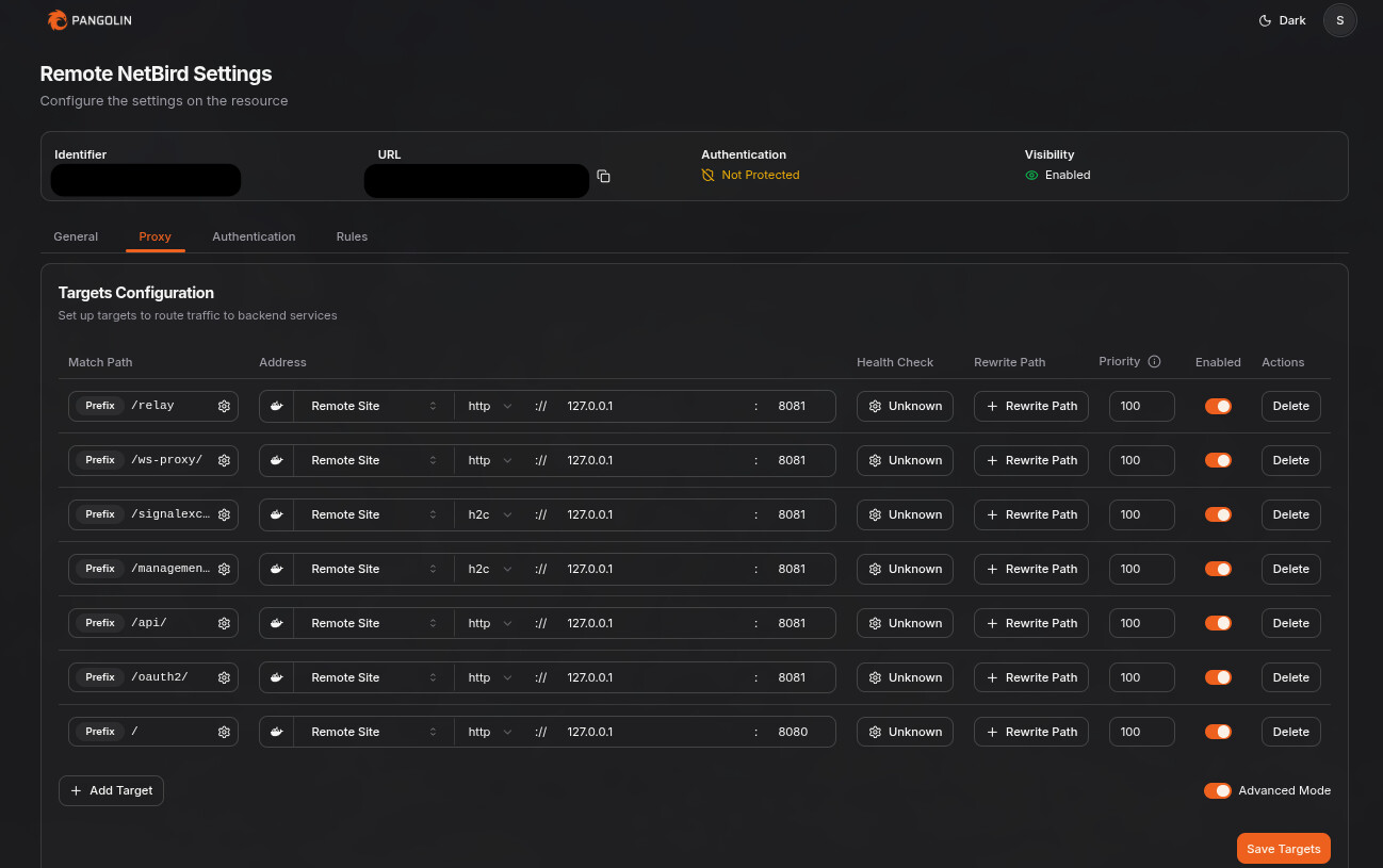

1. For Pangolin and NetBird on Different Servers
Install Newt on remote server and add remote site in Pangolin dashboard. Then Install netbird in netbird directory by using their quick start guide installation script, and when on this step -
Press Enter when your reverse proxy is configured (or Ctrl+C to exit)…
Add reverse proxy configuration in Pangolin, and press enter on Netbird script.

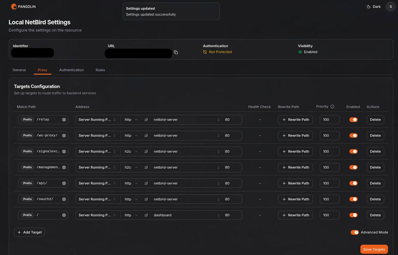

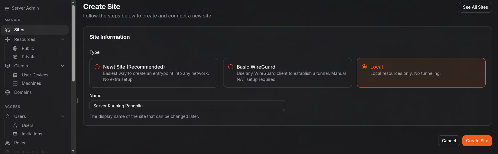

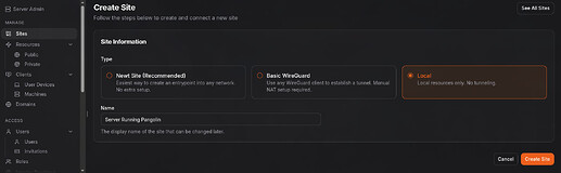

2. For Pangolin and NetBird on Same Server
If you installed both on same server then, first go to Pangolin UI and add your pangolin server as local site in your dashboard -
And then when installing NetBird on this step -
Create a public resource on that local site with the paths provided by netbird
As you can see I’m using direct service names and ports here because I tried using 127.0.0.1 method like in 1st, pangolin was not detecting netbird for me for some reason. So I moved netbird directly to pangolin network as you can see in my below instructions -
Edit your docker-compose.yml file of inside netbird folder, where you installed netbird and make sure pangolin is already running:
# In every service, replace this -
networks: [netbird]
# with this -
networks: [pangolin]
# And for this global networks declaration part in compose file at the bottom, replace this -
networks:
  netbird:
#  with this -
networks:
  pangolin:
    external: true

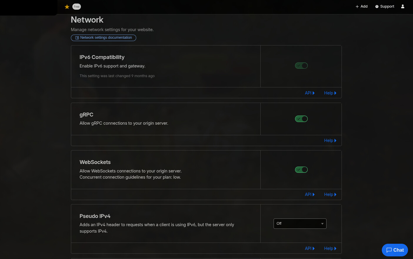

BONUS!

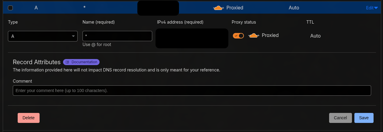

For Cloudflare users, who run pangolin server with Cloudflare Proxy/Orange Cloud - Pangolin Docs turned ON.
Make sure that you enable gRPC in your Cloudflare Dashboard > Your Domain > Network
So that your devices connect properly using STUN. I was facing this problem before and discovered this option today which fixed my problem when using Cloudflare Proxy/Orange Cloud

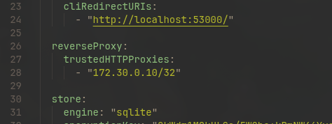

  • 20 Feb 2026
    reverseProxy:
      trustedHTTPProxies:
        - "172.30.0.10/32"
For people like me who are still using Pangolin as their reverse proxy and NetBird as their overlay vpn, I will keep updating the posts. Haven’t tested migration guides myself, as i did fresh install of the combined container version.
