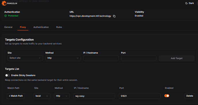

5. Exposing wg-easy via Pangolin
Step A: Add wg-easy to Pangolin’s network
If Pangolin is already running, attach wg-easy to the same external network (pangolin).
docker network connect pangolin wg-easy
Step B: Create a Local Site in Pangolin
  • Go to Sites → Add Site → Local
  • Name: wg-local
Step C: Add Resources
  • Web UI (HTTPS via Traefik)
    • Resource → Add Resource
    • Target: http://wg-easy:51821
    • Subdomain: vpn.example.com
    • Method: http
    • Enable TLS (Let’s Encrypt auto certs via Traefik).

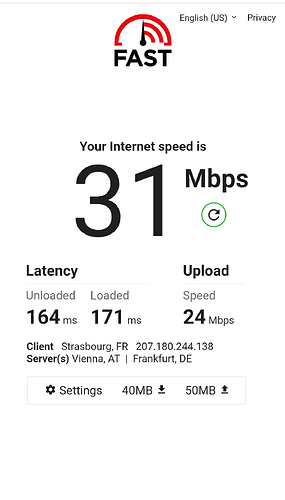

Hi guys
I have attached screenshots. tested on all the 3 OS Ubuntu, Debian and Flatcar (On Pangolin with tunnels and local as well)
Let me know if still you guys face issues. I have kept the test bench running
