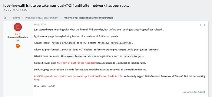

A significant issue has been identified and tracked under Bug 5759, highlighting a vulnerability in how the Proxmox firewall operates during the system boot process. Specifically, the firewall does not apply any rules until the cluster service and network are fully initialized, leaving the host exposed without any firewall protection during that time. This is because the firewall requires access to its configuration files, which are typically stored on networked nodes, meaning that if the cluster service fails to start or encounters a delay, the firewall remains inactive. This gap leaves the host vulnerable to external threats until the configuration is loaded and the firewall becomes operational. It underscores the importance of not relying solely on the built-in Proxmox firewall for host security, as the host could be exposed during critical moments of the boot cycle, especially if the cluster does not properly initialize.

One of the core issues with the Proxmox firewall is its dependency on the cluster services and the network. When a Proxmox server boots, the firewall rules are not applied immediately. This delay occurs because the firewall service requires the cluster to start and load its configuration before it can function.
In practical terms, this means that during the server’s boot-up process, the host is exposed without any firewall rules applied, leaving it vulnerable to potential attacks or unauthorized access. If the cluster services fail to start (either due to configuration issues or other network problems), the firewall rules for the host may never be loaded, leaving the host completely unprotected. While guests may not be able to start, the host itself is still exposed.
