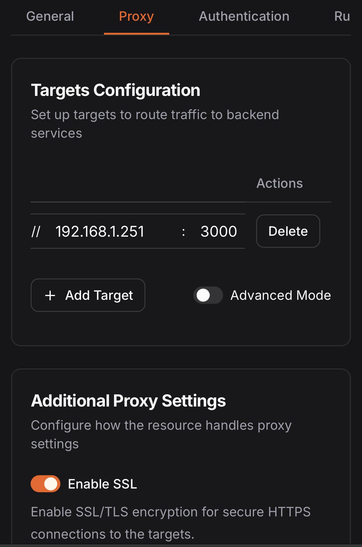

I want to ask about i can access via local ip but unable access on pangolin proxy.
i tried localhost:3000, 127.0.0.1:3000 all unable.
