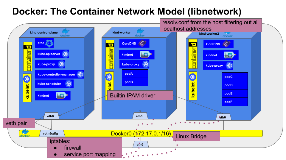

KIND runs Kubernetes cluster in Docker, and leverages Docker networking for all the network features: port mapping, IPv6, containers connectivity, etc.
Docker Networking
KIND uses a docker user defined network.
It creates a bridge named kind
$ docker network ls
NETWORK ID          NAME                DRIVER              SCOPE
3a6a365daaaa        bridge              bridge              local
8405b115c9c1        host                host                local
df31e026ef86        kind                bridge              local
edf13138d1c3        none                null                local
it creates a new bridge in the host, you can get more details using docker network inspect

Docker also creates iptables NAT rules on the Docker host that masquerade the traffic from the containers connected to the kind bridge to connect to the outside world.

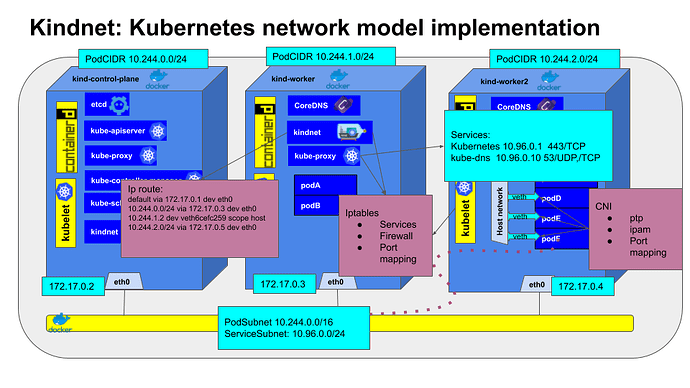

Kubernetes Networking
The Kubernetes network model implies end to end connectivity without NAT between Pods.
By default, KIND uses its own CNI plugin, Kindnet, that install the corresponding routes and iptables rules on the cluster nodes.

In Linux hosts, you can access directly the Cluster IP address of the services just adding one route to the configured serviceSubnet parameters via any of the nodes that belong to the cluster, so there is no need to use NodePort or LoadBalancer services.
