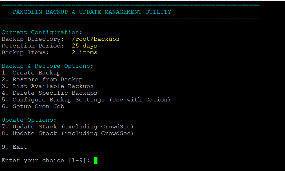

When you run the script without arguments, you’ll see the main menu with these options:
PANGOLIN BACKUP & UPDATE MANAGEMENT UTILITY
Current Configuration:
Backup Directory:  /path/to/pangolin/backups
Retention Period:  60 days
Backup Items:      2 items
Backup & Restore Options:
1. Create Backup
2. Restore from Backup
3. List Available Backups
4. Delete Specific Backups
5. Configure Backup Settings
6. Setup Cron Job
Update Options:
7. Update Stack (excluding CrowdSec)
8. Update Stack (including CrowdSec)
9. Exit
Enter your choice [1-9]:

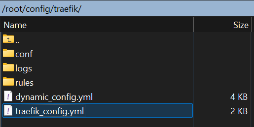

What Gets Backed Up
By default, the script backs up:
  • Your docker-compose.yml file
  • The entire config directory

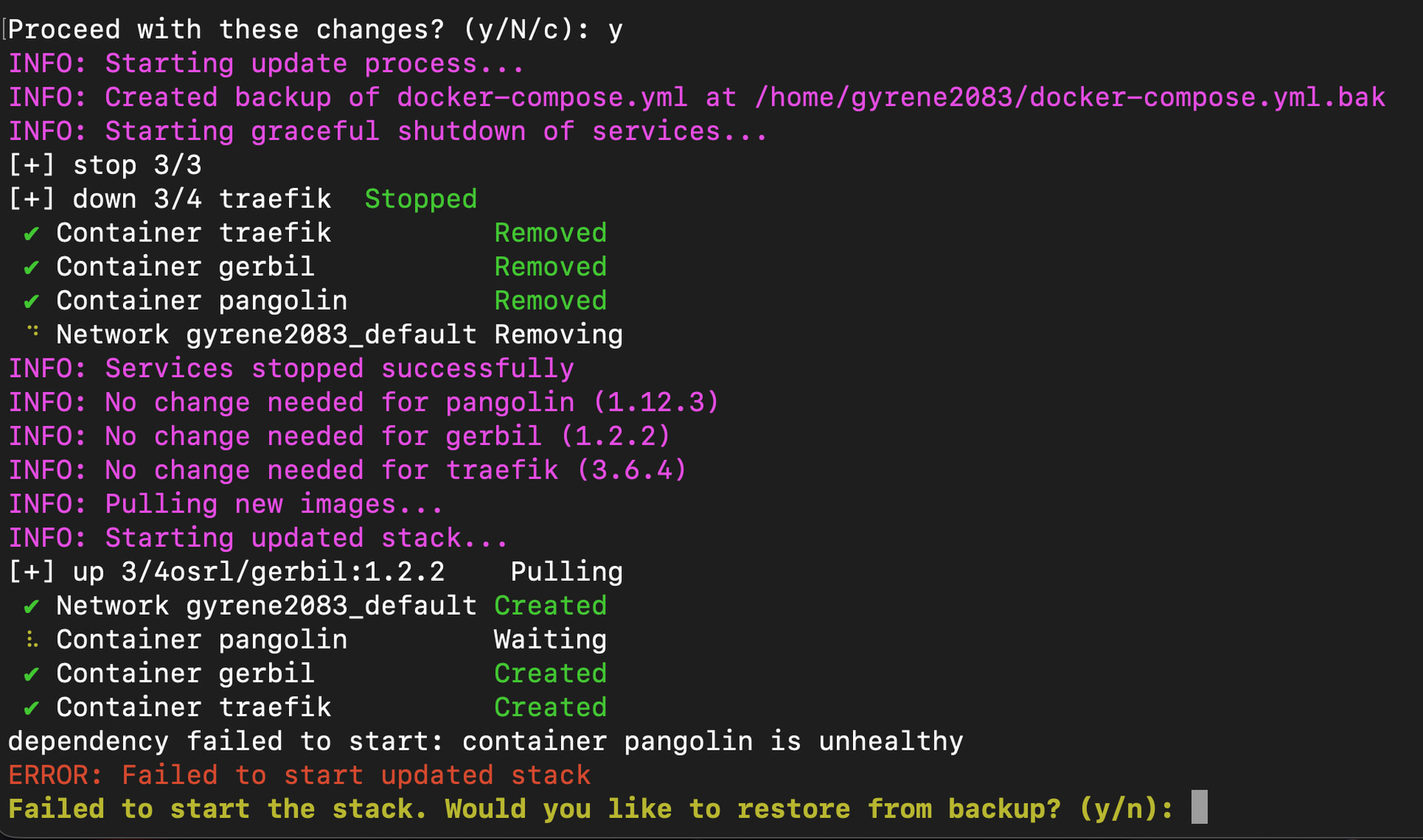

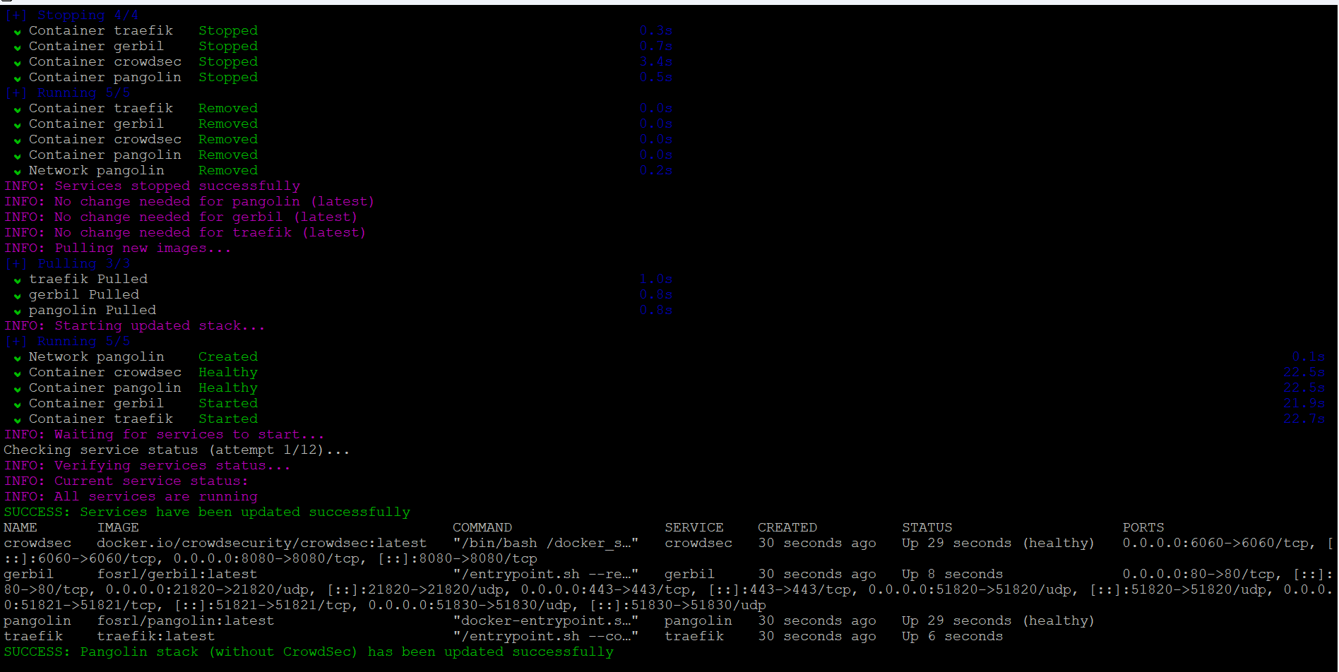

Updating the Pangolin Stack
Basic Update (Without CrowdSec)
  1. Run the script: ./setup_backup_update_manager.sh
  2. Select option 7 from the main menu
  3. The script will:
    • Check your current docker image tags
    • Ask for new versions for each component
    • Backup your current configuration
    • Pull new images
    • Stop and restart services with the new versions
Full Update (With CrowdSec)
  2. Select option 8 from the main menu
  3. Follow the same process as the basic update, but including CrowdSec
Update Process Notes
  • You can press Enter to keep the current version of any component
  • Type c at any prompt to cancel the update
  • The script creates a backup before updating
  • If services fail to start after update, you’ll be offered recovery options
