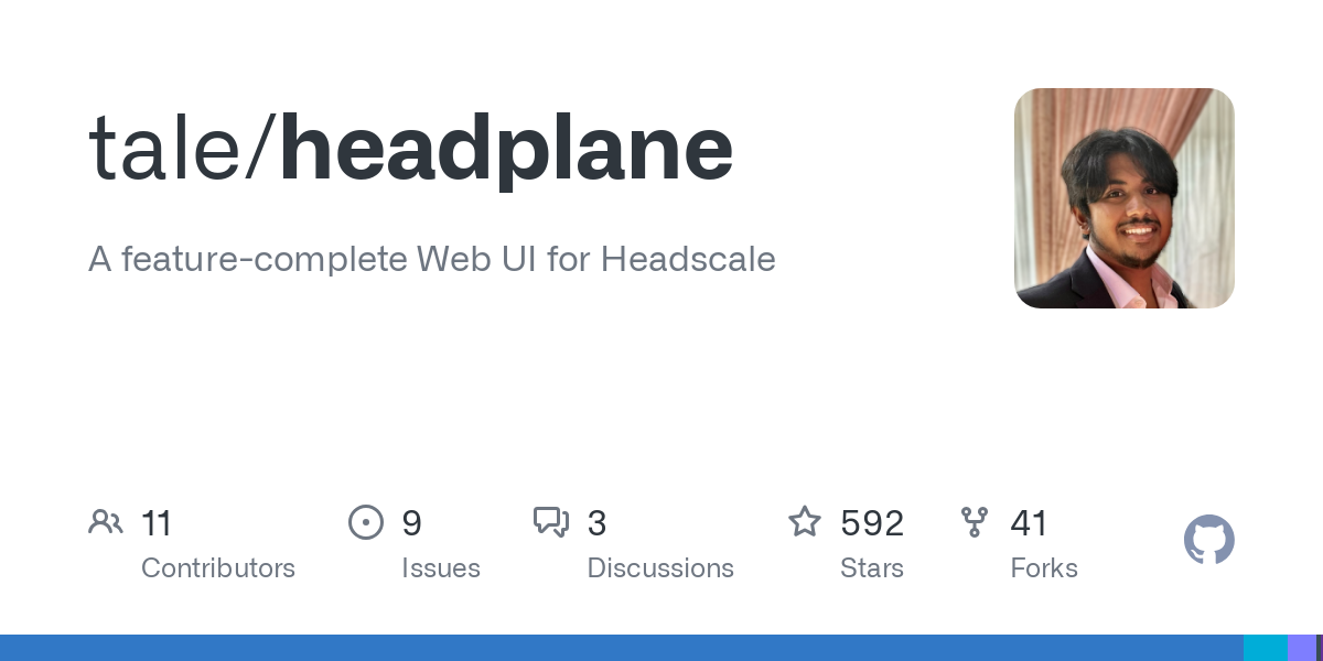

Dude, you’re doing this for free to help out people. Take all the time you need, I really appreciate it. Another option for a web-ui would be →
