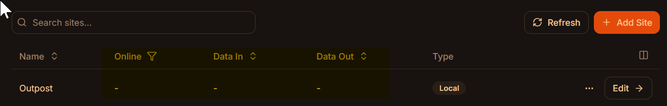

Need help understanding local sites and how to use them
I have read the documentation about sites and a local site is exactly what I need.
Use this to expose resources on the same host as your Pangolin server (self-hosted only). No tunnels are created. Required ports must be open on the Pangolin host.
But the following instructions on how to install sites simply does not mention on how to “install” this site.
Yes, I do understand how to create my separate docker networks on the host. I know how to group containers into different networks to only allow access as intended.
I just don’t understand if I still need to install this local site so it shows in my Pangolin dashboard as connected.
Or are “local sites” never installed and it showing offline is jsut what this text meant?
Local sites do not support:
  • Private resources
  • Health checking
  • Docker socket scanning
If trying to create a private resource, I can’t select this local site. If I try creating a public resource, I can select this local site.
Please help clarify this so I can proceed with Pangolin :slight_smile:
I’m sorry, I must be missing something. How does your reply address any of my questions?
You basically repeated what I said I want to achieve.
Btw. I just forged ahead and managed to access my local resource, but I noticed I can only create a public resource with a local site and no private resource.

I thought the local site is just a kind of placeholder, not an actual `newt` client.
In my setup I do have services I want to expose as public resources on the pangolin VPS, but for some reason I have not figured out what to put in as IP/Hostname.
Might just be me, but I have the same issue and tried `127.0.0.1`, `localhost`, `0.0.0.0` but nothing worked.
This was not clear to me reading the documentaion and it is still not clear to me.

My problem is different. It seems not possible to add private resources to local sites :-/
Interesting, i just looked into my pangolin dashboard and confirm your sighting:
When adding a private resource i also cant select my local site (pangolin vps machine).
Maybe it just was missed to be implemented?
