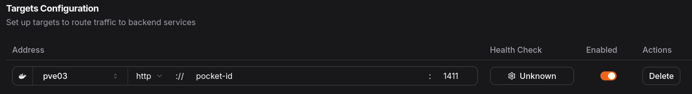

My plan was to move traefik away from using network_mode: service:gerbil, so I modified my compose file as below with the result that everything works, except the sites on my other server running newt. It seems I have a newt/gerbil issue at hand somehow.
This is how I set up a public site, accessible via newt on a different server:
The remote newt’s logs seem perfectly fine.

New compose which leads to the above problem:

I have rechecked pangolin’s docs and found out that network_mode: service:gerbil is actually the suggested usage. I never knew. I did that “workaround” when I couldn’t get stuff working without it.
I guess I’ll leave it at that.
network_mode: service:gerbil is critical in the standard Pangolin stack because Gerbil owns the WireGuard network namespace where all the tunneling magic (Newt peers) happens. Traefik must share that exact network stack to properly route traffic to remote Newt instances.
