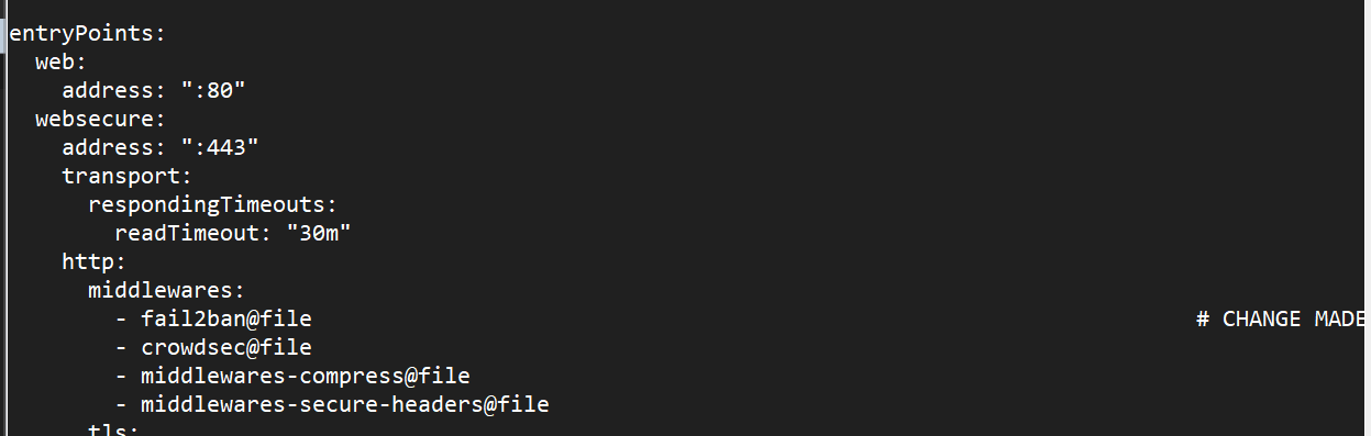

3. Apply Middleware to traefik file
Update your http configurations in traefik_config.yml to use the Fail2Ban middleware. Add fail2ban to the middlewares list.
    http:
      middlewares:
        - fail2ban@file                                                                   # CHANGE MADE HERE (BOUNCER ENABLED) !!!
        - crowdsec@file
        - middlewares-compress@file
        - middlewares-secure-headers@file

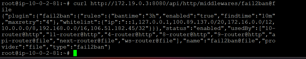

Verify Active Bans
Access Traefik’s API dashboard (if enabled in compose file):
curl http://172.19.0.3:8080/api/http/middlewares/fail2ban@file

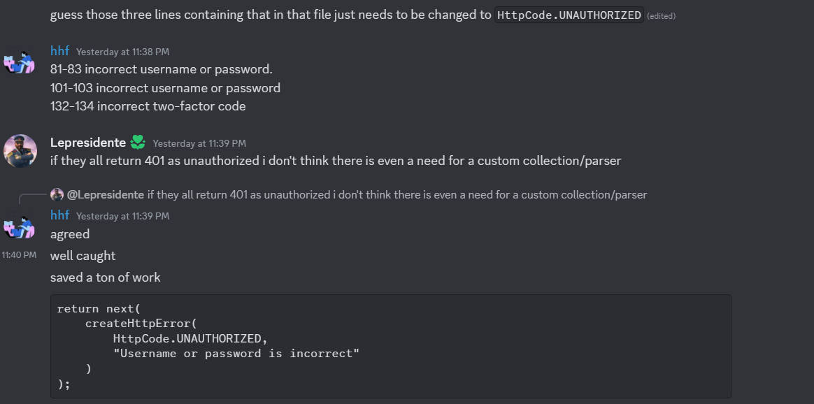

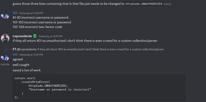

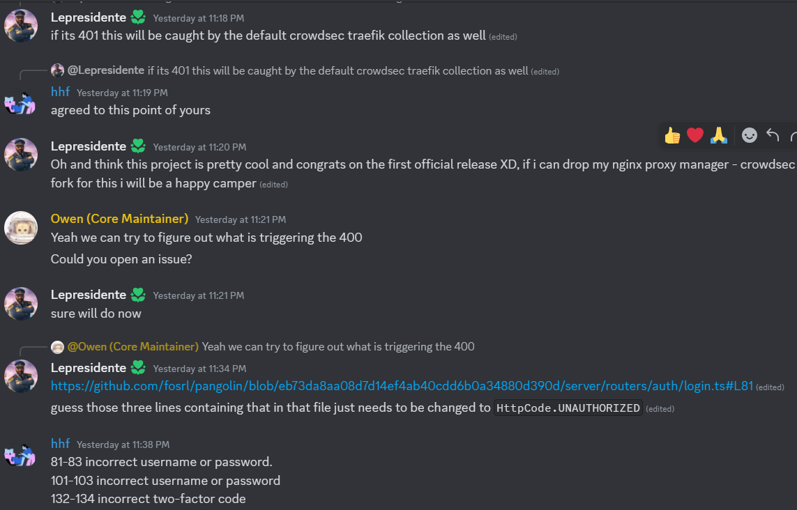

What if I have a dynamic IP? your-ip/32 doesn’t seem to work long-term in a dynamic-ip scenario, right? Seems like I’ll be auto-banned every time my ip4 rotates?
yes, you are right. fail2ban is more complicated. and it should be dployed on auth error only. false positive are really annoying
How would one go about deploying it “on auth error only”?
there is small bug in pangolin. developer are looking at it.
Solved in the latest updated. pangolin 1.0.1

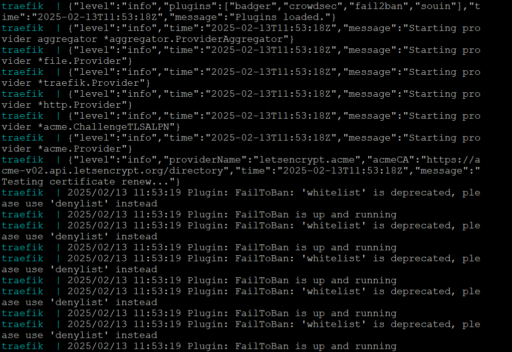

2025/03/11 15:39:53 Plugin: FailToBan is up and running :raising_hands:
Awesome. Have fun with the project.
