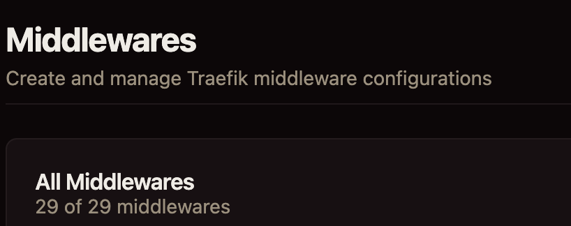

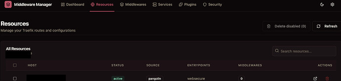

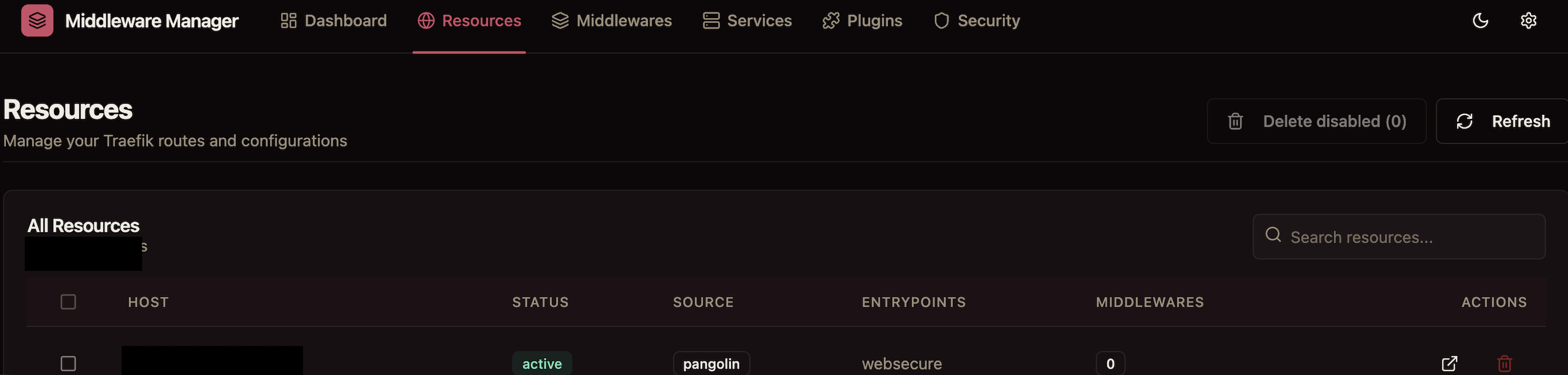

Under resources, zero middlewares are recognized. However under middlewares, 29 are recognized. Do I need add middlewares to resources or is it just displaying incorrect information?
