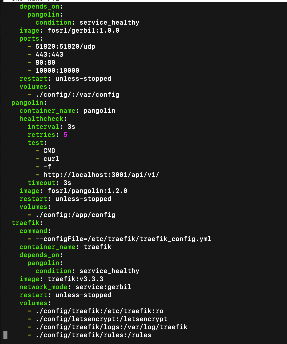

:test_tube: Step 4: Expose the Tinyauth Port
Update your gerbil service in Docker Compose to expose the Tinyauth port:
    ports:
      - 10000:10000  # Exposes Tinyauth

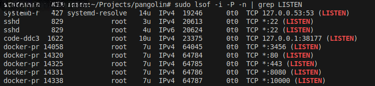

sudo lsof -i -P -n | grep LISTEN
:magnifying_glass_tilted_left: Screenshot: this is the command and the result with :10000 showing in the list.

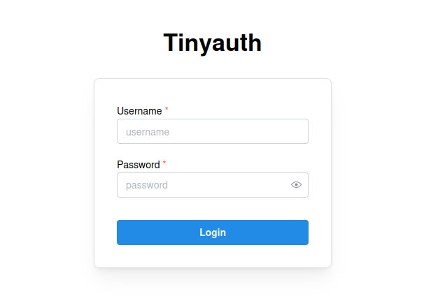

In your browser, open an incognito tab and visit:
https://tinyauth.mydomain.com
You should see the Tinyauth login page.

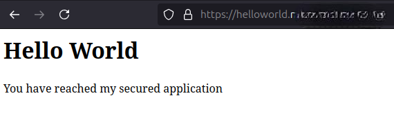

Verify it works without authentication first.
:camera_with_flash: Screenshot Here’s my URL unauthenticated.

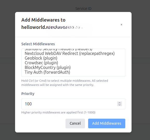

:shield: Step 9: Attach Middleware in Pangolin
  1. Open the Pangolin Middleware Manager UI.
  2. Navigate to the Middlewares tab.
    • Confirm you see Tinyauth listed.

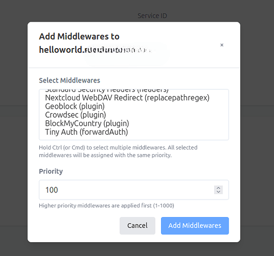

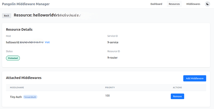

  3. Return to the Dashboard and click Manage next to the resource you want to protect.
  4. Under Attached Middlewares, click Add Middleware.
  5. Select Tinyauth (forwardAuth) and click Add Middlewares.
:camera_with_flash: Screenshot: Here’s the middleware list and the form where you attach Tinyauth.
:white_check_mark: Step 10: Final Test
Open your protected resource in an incognito window:
https://resourcename.mydomain.com
You should be redirected to https://tinyauth.mydomain.com for login. After authenticating, you’ll return to the protected app.

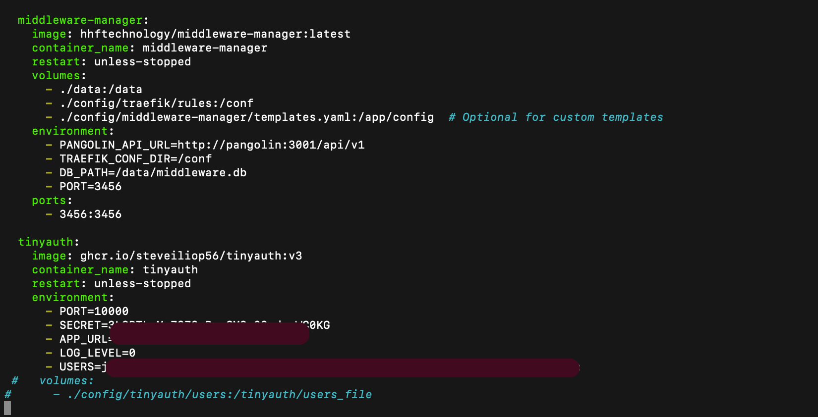

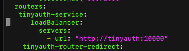

In my case it does not work. This part in the dynamic_config.yml, when I enable it, in all the URL of Pangolin it comes out “error 404 not found”. If I disable only this block, if the rest works (No tinyauth).
The rest of the tutorial I have followed as you indicate and it is working.

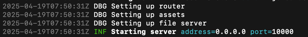

Tinyauth logs
Docker Compose (part modified)
http:
  middlewares:
    redirect-to-https:
      redirectScheme:
        scheme: https
  routers:
    # HTTP to HTTPS redirect router
    main-app-router-redirect:
      rule: "Host(`pangolin.development.hhf.technology`)"
      service: next-service
      entryPoints:
        - web
      middlewares:
        - redirect-to-https
    # tinyauth router
    tinyauth-router-redirect:
      rule: "Host(`tinyauth.development.hhf.technology`)"
      service: tinyauth-service
      entryPoints:
        - web
      middlewares:
        - redirect-to-https
    # Next.js router (handles everything except API and WebSocket paths)
    next-router:
      rule: "Host(`pangolin.development.hhf.technology`) && !PathPrefix(`/api/v1`)"
      entryPoints:
        - websecure
      tls:
        certResolver: letsencrypt
    # API router (handles /api/v1 paths)
    api-router:
      rule: "Host(`pangolin.development.hhf.technology`) && PathPrefix(`/api/v1`)"
      service: api-service
      entryPoints:
        - websecure
      tls:
    # WebSocket router
    ws-router:
      entryPoints:
        - websecure
      tls:
    # tinyauth router
    tinyauth:
      entryPoints:
        - websecure
      tls:
  services:
    next-service:
      loadBalancer:
        servers:
          - url: "http://pangolin:3002"  # Next.js server
    api-service:
      loadBalancer:
        servers:
          - url: "http://pangolin:3000"  # API/WebSocket server
    tinyauth-service:
      loadBalancer:
        servers:
          - url: "http://tinyauth:10000"
Now yes! Thank you so much ! :grinning_face_with_smiling_eyes:
The gerbil 10000 does nothing you never wired it to anything so not sure why that even exists? As unless you make a traefik entrypoint to listen on 10000 it’ll do nothing, If it’s to allow cross talk, All ports are opened between containers regardless of what’s defined.
