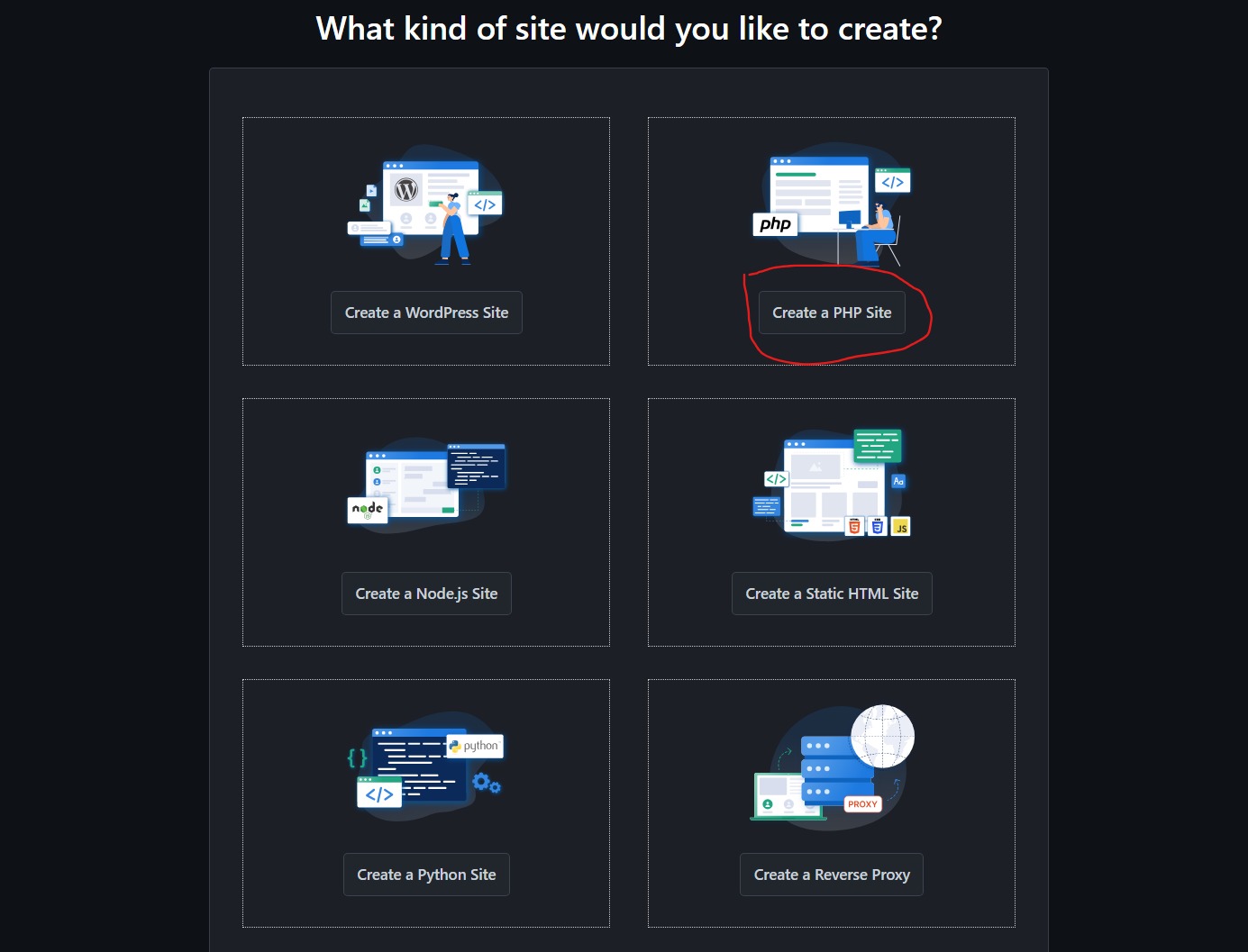

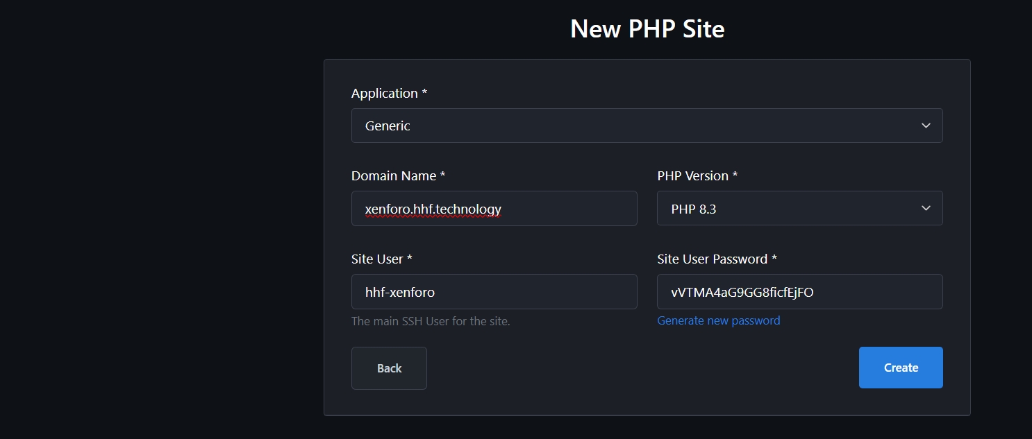

1. Create a Site in CloudPanel
- Go to Sites
- Click Add Site
- Enter your domain name (e.g.,
xenforo.yourdomain.com) - Select PHP version (recommended: PHP 8.3)
- Choose Generic as the application
- Click Add Site

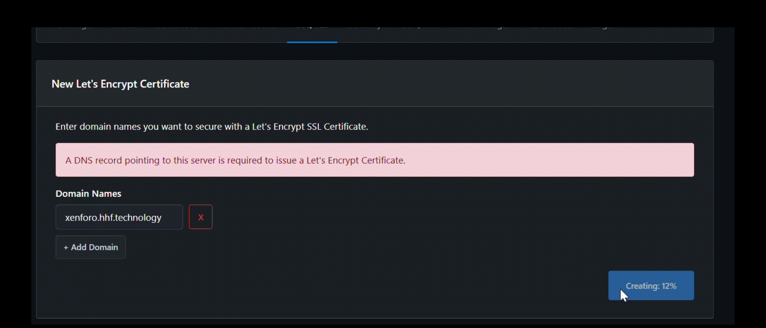

- Set up SSL certificate:
- In CloudPanel, go to Sites > Your Domain > SSL/TLS
- Click Add SSL/TLS Certificate
- Choose Let’s Encrypt or upload your own certificate

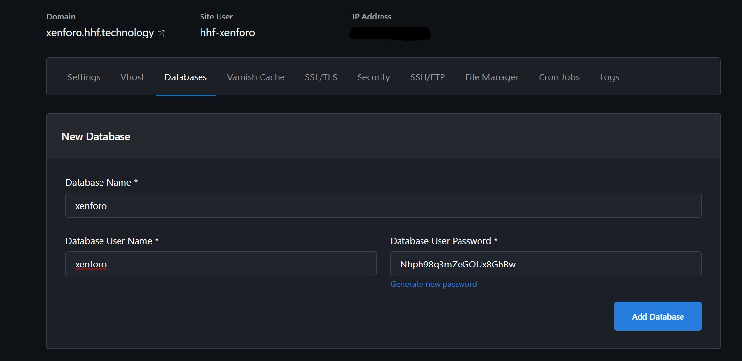

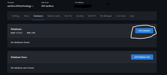

2. Create a Database
- Navigate to Databases
- Click Add Database
- Fill in the following details:
- Database Name:
xenforo(or your preferred name) - Database User:
xenforo(or your preferred username) - Password: Generate a secure password
- Database Name:
You don’t need to touch the Vhost. It work perfectly fine with the current version of Xenforo

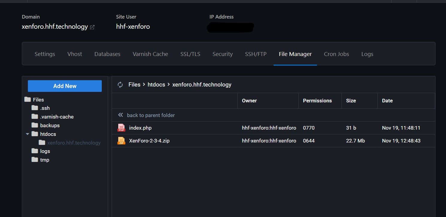

3. Download and Install Xenforo
Upload the ZIP to your file manager:

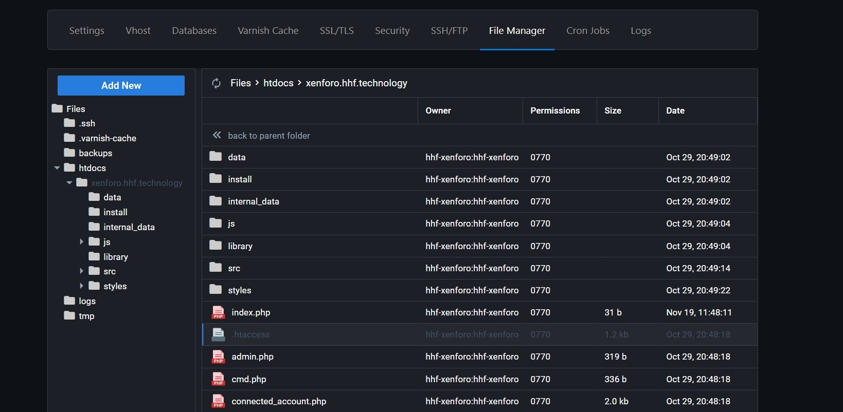

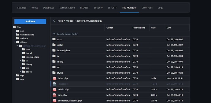

Now extract it to the :
/home/cloudpanel/htdocs/your-domain

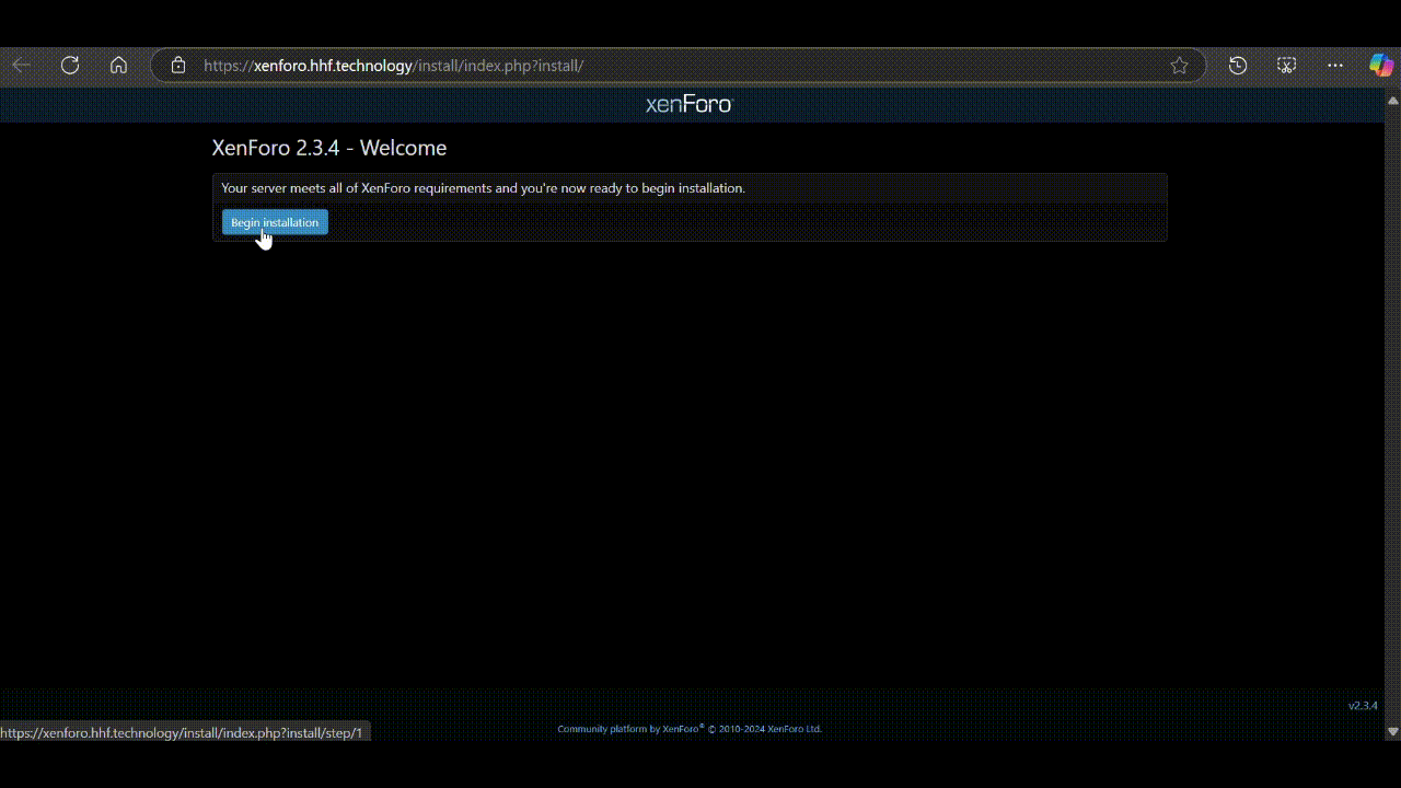

4. Run the Installation Script
- Open your web browser and navigate to:
https://xenforo.yourdomain.com/install
- Follow the installation wizard:
- Verify system requirements
- Enter database credentials
- Create admin account
- Configure site settings
