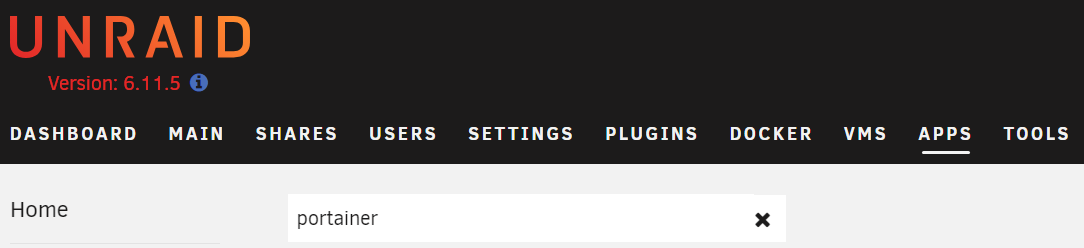

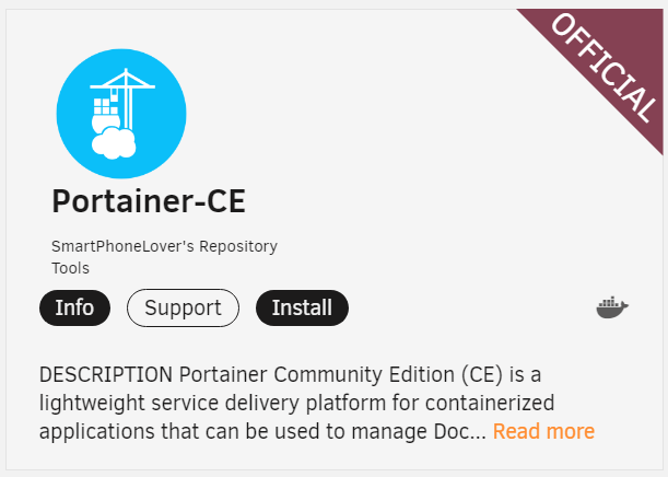

  1. Log in to Unraid and navigate to the Apps section. Search for Portainer.
  2. Click on Install for the Portainer-CE official version to launch the installation dialogue.

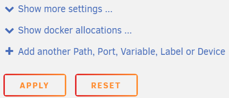

  4. Click Apply to create the container. The Portainer image will be downloaded.

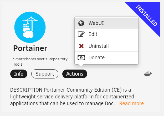

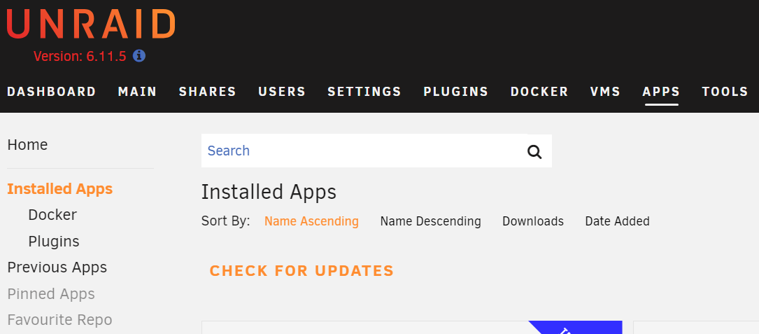

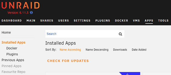

  1. Navigate to Apps, then select Installed Apps.
  2. Click on Portainer, then select Actions, and finally click on WebUI.

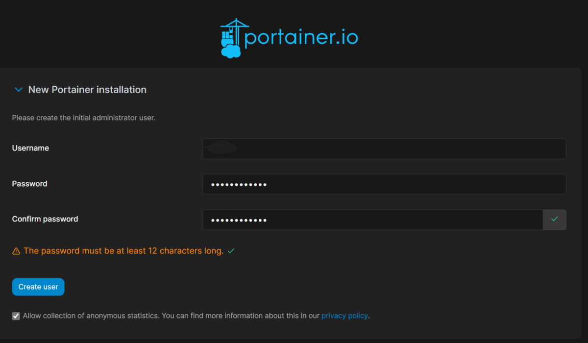

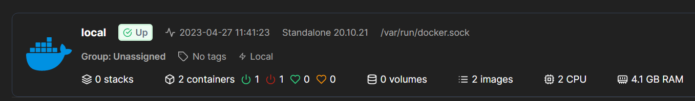

  3. Create a username and password for Portainer.

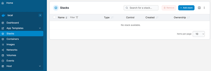

  4. Select Get Started, then choose Local to access local containers on Unraid.
    Note: If you are running other Docker containers on Unraid, you can manage them with Portainer as well!
Nextcloud Container Configuration on Unraid

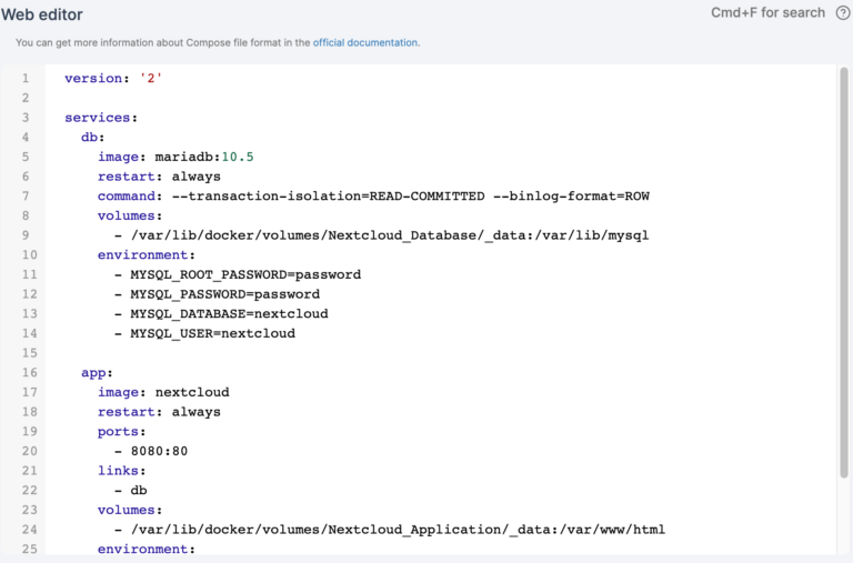

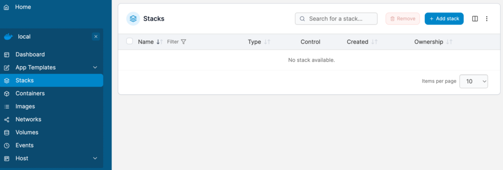

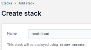

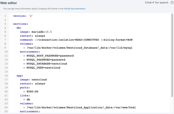

  1. In Portainer, select Stacks, then click on Add Stack to create a new stack for Nextcloud and its database.
  2. Name the stack as nextcloud.
  3. Paste the following contents into the web editor. A few important notes:
    • You can adjust the volume details as needed. Ensure these paths are where all important Nextcloud data will be stored; if you plan to back up or migrate this container, these folders must be preserved.
    • Update the passwords in the configuration below, ensuring that MYSQL_PASSWORD matches for both Database and Nextcloud containers.
version: '2'

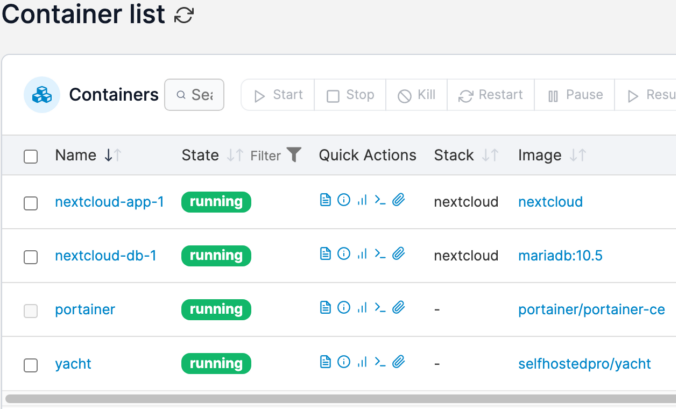

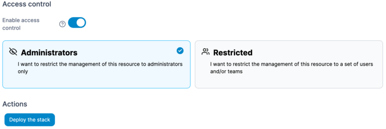

  1. After making all necessary changes, click Deploy the stack at the bottom to create both containers.
  2. The containers should now be created—one for Nextcloud and one for its database.

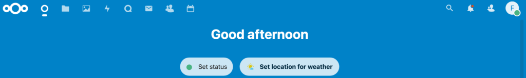

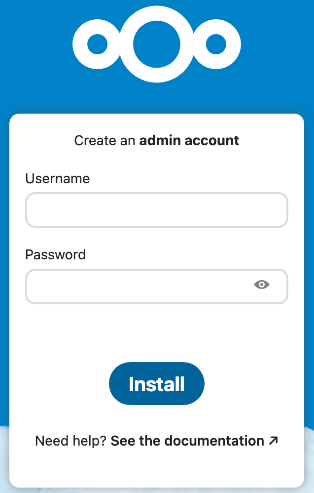

  1. Navigate to your Unraid server’s IP address followed by port 8080 in your web browser:
http://[UNRAID_IP]:8080

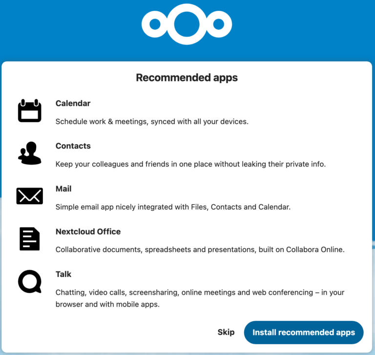

Set up a username and password on the initial screen, then click Install.

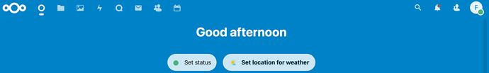

  1. You can choose to install recommended apps or skip this step; if you install apps, this process may take a few minutes.
  2. Once completed, your Nextcloud instance will be ready for use!
