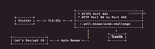

Letsencrypt creates and renews ssl certificates by contactin traefik over port 80 to check that the IP address associated with the domain is correct.

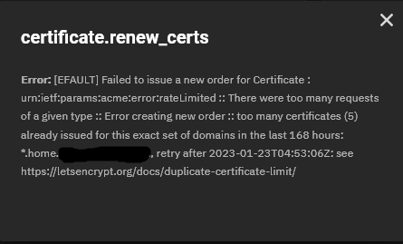

If you could up against this rate limit you will see something like this in your traefik.log
tail -f \var\log\traefik\traefik.log
Too many certificates already issued for this exact set of domains in the last 168 hours.

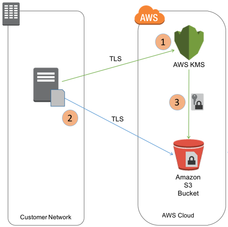

:light_bulb: Tip: Use an S3 bucket encrypted with KMS and an IAM role with limited read/write permissions.

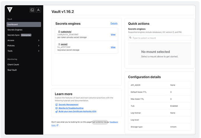

:locked_with_key: Vault-Based Bootstrap
If you already use HashiCorp Vault for your secrets, it can easily manage your acme.json file too.
Vault variant:

:light_bulb: Security best practice: Use Vault’s Transit engine or policy-based ACLs to protect acme.json contents at rest.
:framed_picture: Screenshot -Vault UI “Secrets” tab
