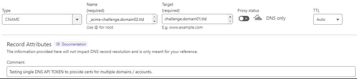

  • In the secondary domain’s DNS (e.g., domain02.tld in account “bar”):
    • Add a CNAME record:
      • Name: _acme-challenge.domain02.tld (or _acme-challenge if using root).
      • Target: challenge.domain01.tld (a subdomain in the primary account).
      • Proxy: DNS-only (not proxied, as it must resolve directly).
      • TTL: Auto or low (e.g., 300 seconds).
    • Example screenshot reference: The provided image shows this setup in Cloudflare, with a comment noting it’s for testing a single API token across multiple domains/accounts.

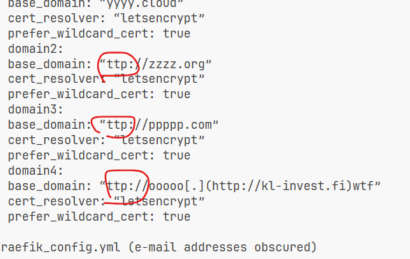

Hi
Thank you for the guide. I followed the guide, but traefik (pangolin) still gives the following error for other than the main domain:
traefik | 2025-10-01T11:03:53Z ERR Unable to obtain ACME certificate for domains error=“unable to generate a certificate for the domains [xxxx<.com]: order identifiers have been by the ACME server (RFC8555 §7.1.3): [{Type:dns Value:xxxxcom} {Type:dns Value:kl-xxxxx.com}] != [{Type:dns Value:xxxx.com}]” ACME CA=hXttps://acme-v02.api.letsencrypt.org/directory acmeCA=htxtps://acme-v02.api.letsencrypt.org/directory domains=[“xxxx<.com”,“xxxx.comi”] providerName=letsencrypt.acme routerName=next-router@file rule=“Host(proxy.yyyy.cloud) && !PathPrefix(/api/v1)”
I added dns CNAME for _acme-challenge.xxxx.com –> challenge01.yyyy.cloud
This error keeps repeating. I also changed the configuration files to reflect the guide.
How do i go about troubleshooting this?
I also have problems with pangolin giving 404 errors for sites that i create.
I see what’s happening — your logs are showing two separate but related issues:
1. ACME / Let’s Encrypt error
The key part of the error is:
That means Let’s Encrypt is rejecting the certificate request because the domain names in your router rule and the ACME challenge don’t line up. Common causes:
  • Typo in domain: I see xxxx<.com and xxxx.comi in your log — those look like copy/paste or config typos. Even a stray < or i will cause a mismatch.
  • CNAME delegation: You added _acme-challenge.xxxx.com → challenge01.yyyy.cloud. That’s correct in principle, but you need to confirm with dig or nslookup that it resolves properly:
    dig TXT _acme-challenge.xxxx.com
    It should return the TXT record Traefik created under challenge01.yyyy.cloud. If it doesn’t, Let’s Encrypt won’t validate.

Pangolin config.yml (relevant part, edited out domain names and made the unlinkable. Removing “h”)
> gerbil:
> start_port: 51820
> base_endpoint: “proxy.yyyy.cloud”
> app:
> dashboard_url: “ttps://proxy.yyyy.cloud”
> log_level: “info”
> telemetry:
> anonymous_usage: true
> domains:
> domain1:
> base_domain: “yyyy.cloud”
> cert_resolver: “letsencrypt”
> prefer_wildcard_cert: true
> domain2:
> base_domain: “ttp://zzzz.org”
> domain3:
> base_domain: “ttp://ppppp.com”
> domain4:
> base_domain: “ttp://ooooo[.](http://kl-invest.fi)wtf”

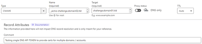

DIG TXT \_acme-challenge.xxxx.fi gives following answer (i obscured domains)
> ;; OPT PSEUDOSECTION:
> ; EDNS: version: 0, flags:; udp: 65494
> ;; QUESTION SECTION:
> ;\_acme-challenge.xxxx.fi. IN      TXT
> ;; ANSWER SECTION:
> \_acme-challenge.xxxx.fi. 120 IN   CNAME   challenge01.yyyy.cloud.
> challenge01.yyyy.cloud. 120    IN      TXT     “tQFCVnCw7E8L-NCgbJc6Yf0dB8DttsiUnKpGUYfPhfM”
> challenge01.yyyy.cloud. 120    IN      TXT     “Xq2TUFUeIrGmHJauTSA581jJLZz8BeuDyE2smHUEbv8”
It seems that the challenge TXT is there. But i don’t see where the error is. Restarted the containers. Still getting the errors.

same mistake throughout
  1. Clean up all base_domain entries to be just the domain (no scheme).
  2. Correct typos in caServer and plugin URLs.
  3. Restart Pangolin + Traefik.
  4. Run dig TXT _acme-challenge.yourdomain.com again to confirm delegation.
  5. Watch Traefik logs with log.level=DEBUG to see exactly which domains it’s requesting certs for.
Once those are fixed, your ACME errors and 404s should clear up or share your logs
