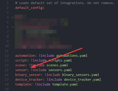

To do this, go to the configuration.yaml file which is located in the config folder of the Home Assistant application.
You can use two methods: create a separate sensors.yaml file in which we will have separate sensor configuration from the main assistant settings.
In configuration.yaml file add among similar such lines.
then create the sensors.yaml file in the config directory (the root directory, the same directory where the configuration.yaml file is located)
Add the following code in it:
