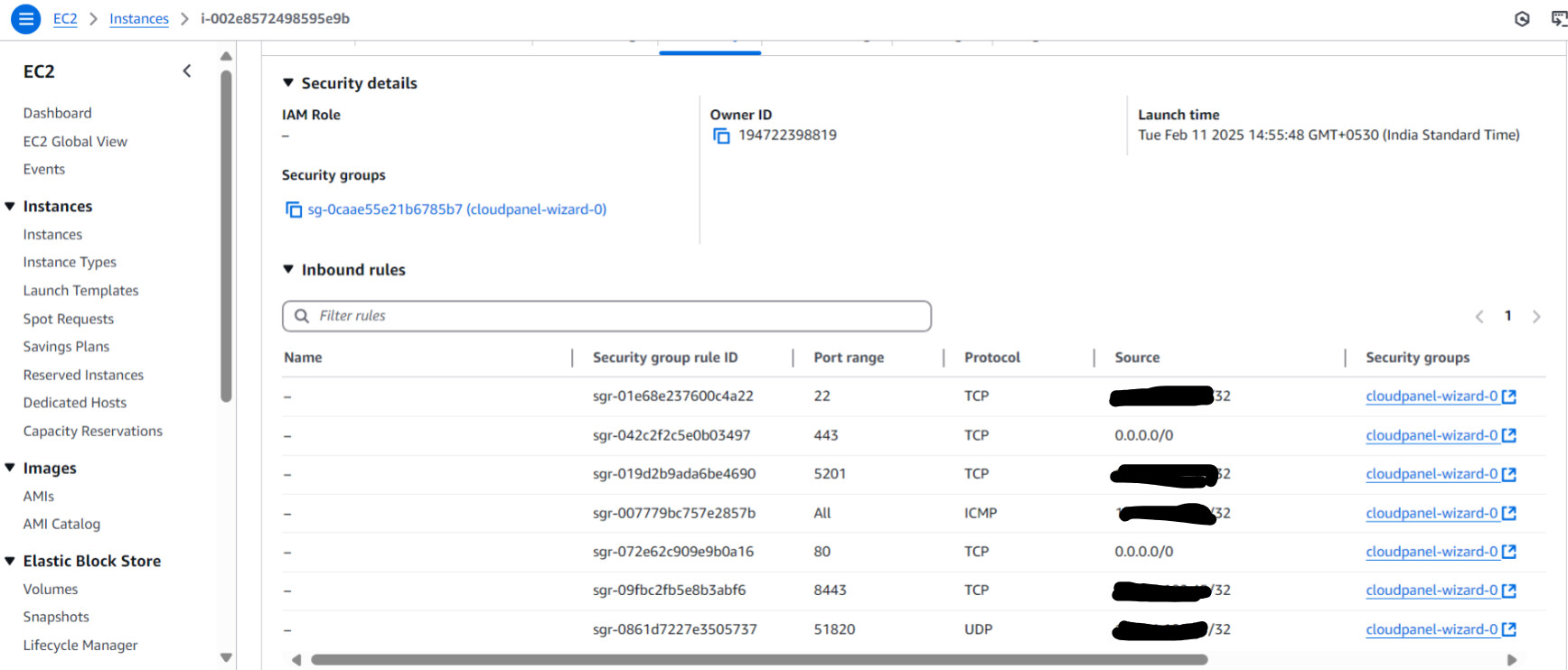

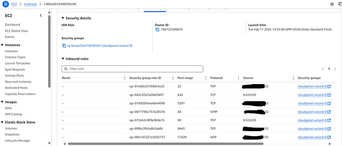

As a prerequisite to deployment, confirm the following: (1) all required network ports are open and accessible (TCP 80, TCP 443, UDP 51820); and (2) the DNS records for your domain correctly resolve to the public IP address of your Flatcar VPS.

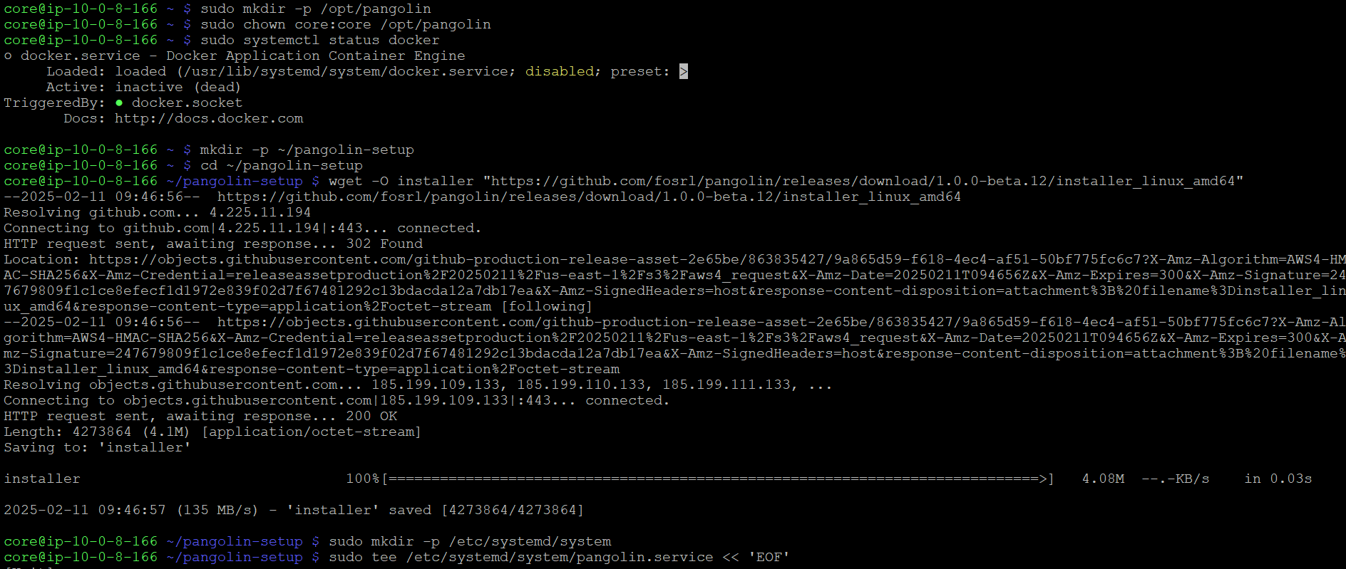

Create a persistent directory for Pangolin data since Flatcar OS uses an immutable filesystem:
sudo mkdir -p /opt/pangolin
sudo chown core:core /opt/pangolin
cd /opt/pangolin

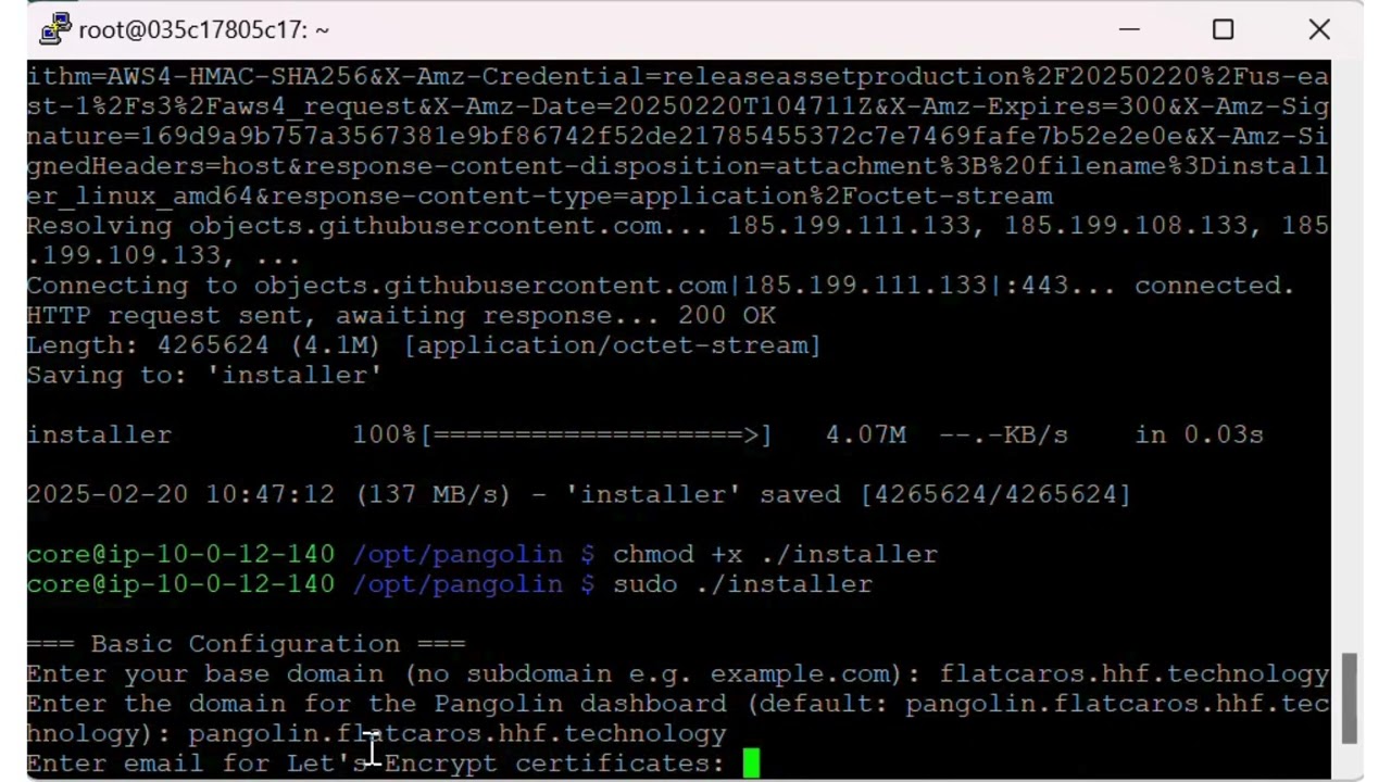

3. Download the Pangolin Installer
Download the Pangolin installer:
wget -O installer "https://github.com/fosrl/pangolin/releases/download/1.0.0-beta.14/installer_linux_amd64"
chmod +x ./installer
4. Run the Installer

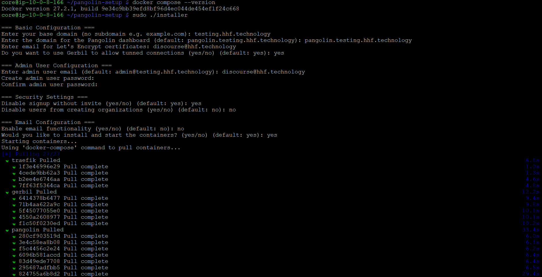

Run the installer with sudo:
sudo ./installer
When prompted, provide the following information:
  • Your base domain name (e.g., example.com)
  • Dashboard domain name (e.g., proxy.example.com)
  • Let’s Encrypt email address
  • Choose whether to install Gerbil for tunneling
  • Set up admin user credentials
  • Configure security settings
  • Set up email configuration (optional)

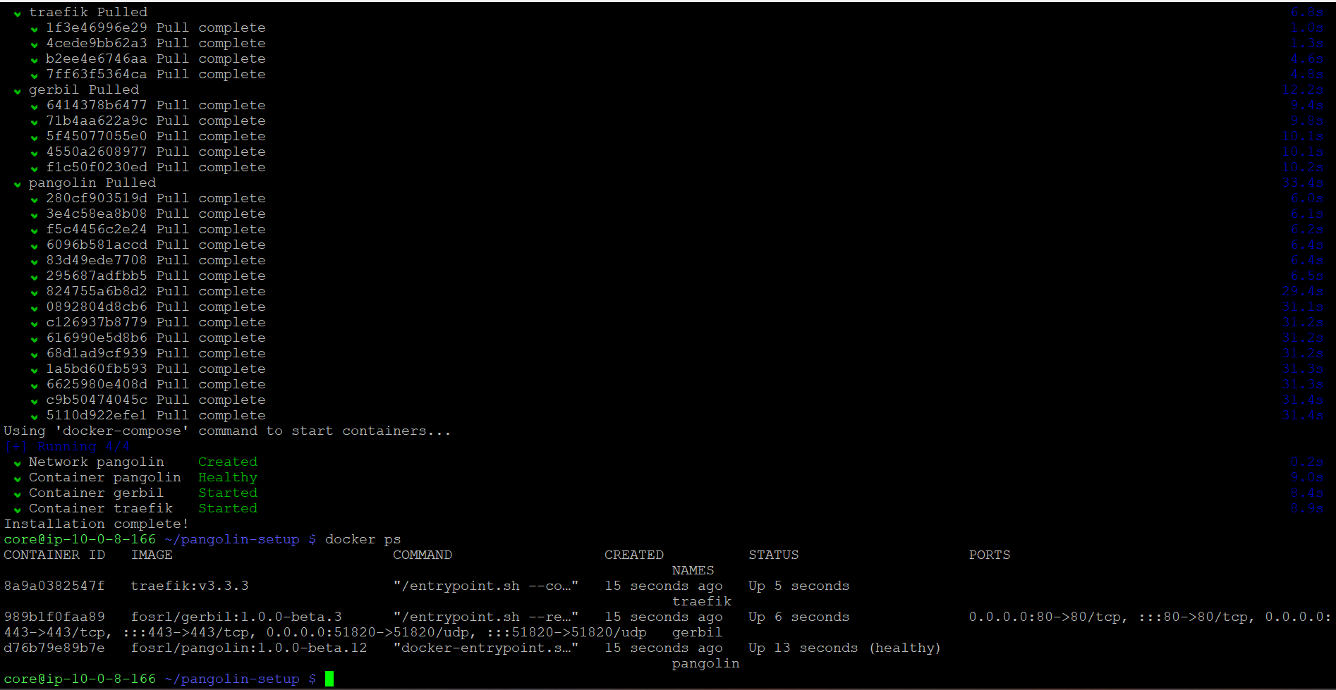

7. Verify Installation
Check if all containers are running:
cd /opt/pangolin
/opt/bin/docker-compose ps
You should see containers for:
  • Pangolin
  • Traefik
  • Gerbil (if you chose to install it)
