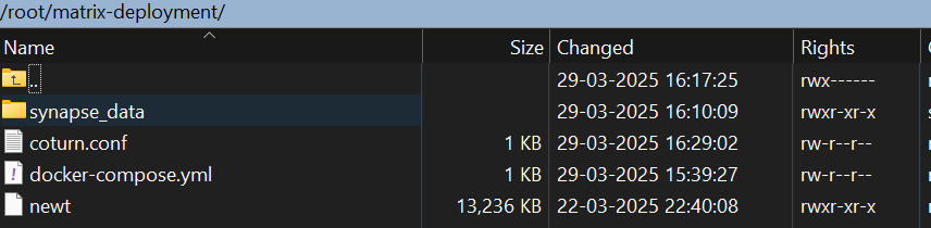

1.1 Create Directory Structure
Create a directory for your Matrix setup and navigate into it:
mkdir matrix-deployment
cd matrix-deployment

Download Newt (Pangolin’s tunneling client) for your platform, then run it with the credentials from the dashboard:
./newt \
  --id YOUR_NEWT_ID \
  --secret YOUR_NEWT_SECRET \
  --endpoint https://your-pangolin-domain.com
  • Keep Newt running in a terminal or as a background service.
  • This establishes the WireGuard tunnel between your local machine and the VPS.

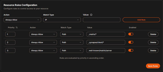

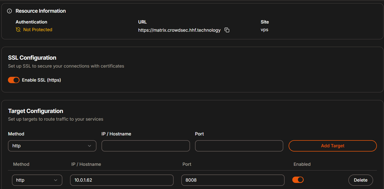

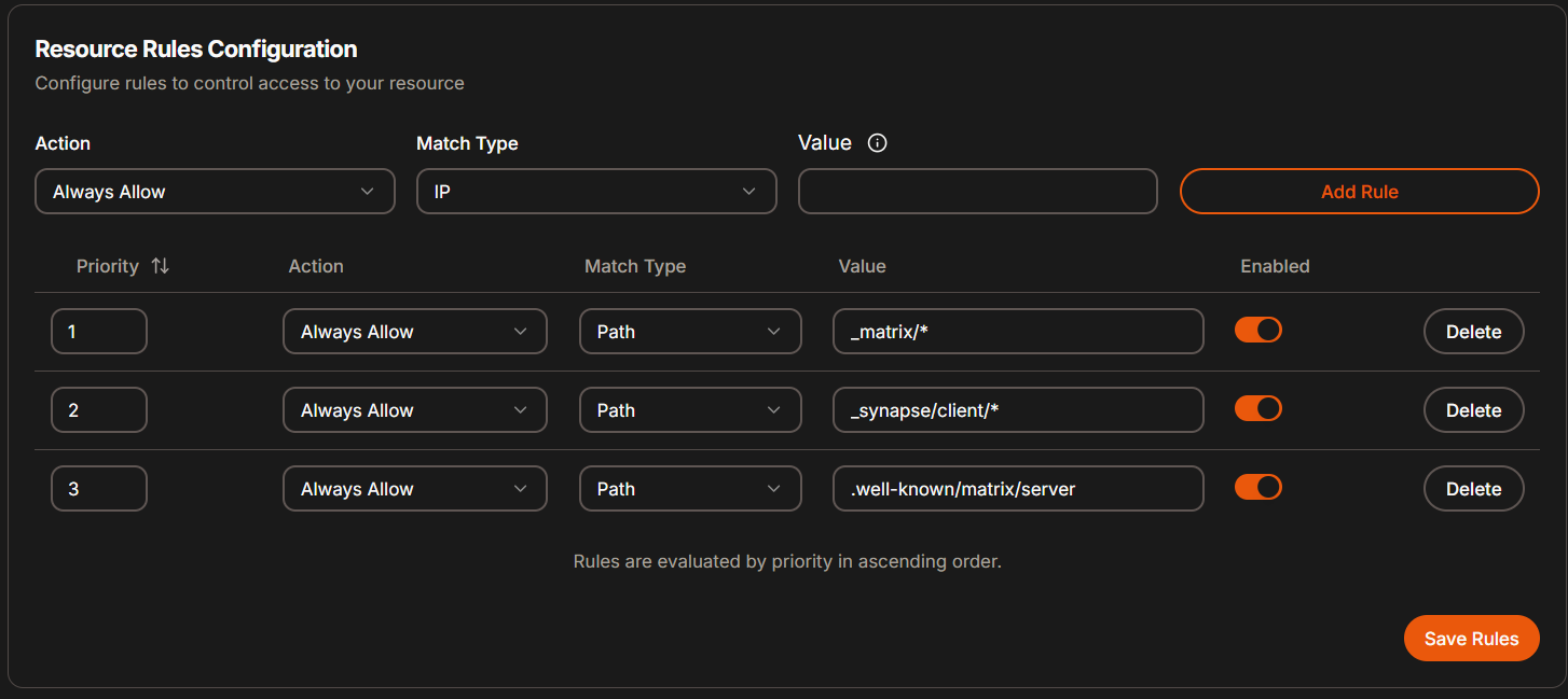

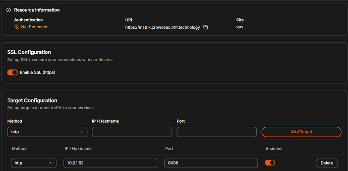

  1. Matrix Client API (HTTP on Port 8008):
    • Type: HTTP
    • Domain: matrix.example.com
    • Entry Point: websecure (port 443)
    • Target: <synapse-container-ip>:8008 (e.g., 172.18.0.2:8008, find this using docker inspect synapse on your local machine)
    • Path: /_matrix/*
    • Path: _synapse/client/*
    • Path: .well-known/matrix/server

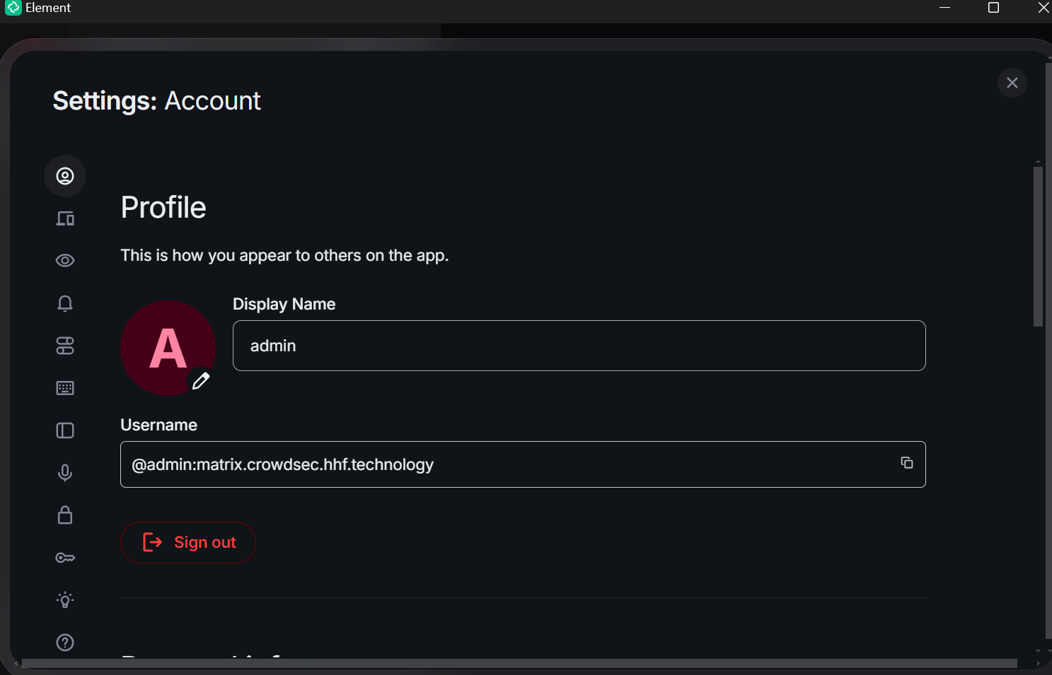

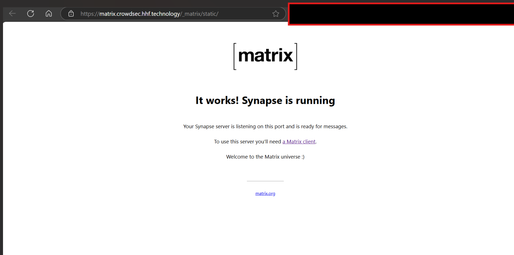

Step 7: Test Your Deployment
  1. Client Access:
    • Open a browser or Matrix client (e.g., Element) and connect to https://matrix.example.com.
    • Register a user to confirm the client API works.
      https://federationtester.matrix.org/#matrix.crowdsec.hhf.technology
