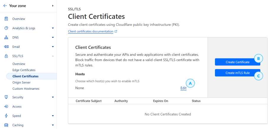

Step 3: Configuring client certificates (mTLS)
What is mTLS? - We will configure mTLS matching as a WAF rule, but you can also configure it inside the Zero Trust dashboard.
Creating certificates and setting the WAF rule
You need to go to Your zone > SSL/TLS > Client Certificates
A | Set the hosts (View image)
First we will set on which host we will enable mTLS, click Edit
, add your hostname (example: home.fabrizz.co
), and then click save
B | Create the certificates (View image)
Then we need to generate or certifitate pair, click Create certificate
, then click Generate private key and CSR with Cloudflare
(RSA 2084 should be selected by default, you can change the validity of your cert if you want), then click Create
Now we should see our key pair!, copy the certificate to a cert.pem
file, and the private key to a key.pem
file.
(You can use Notepad, Notepad++, VSCode, etc to edit/create this files)
[!caution]
- You must keep the newline at the end of both cert files!
- Once you click
OK
, the certificates are not shown again!- IOS WS connections do not work correctly! Explained at the top of the gist.
C | Create WAF rule (View image)
Now we will block every connection to the origin server if the client cert is not present. You should check before this change that everything works and that your instance is reachable using the tunnel. You should use HTTPS.
Now click Create mTLS rule
, this will bring you to Security > WAF
, with a preapplied template for mTLS.

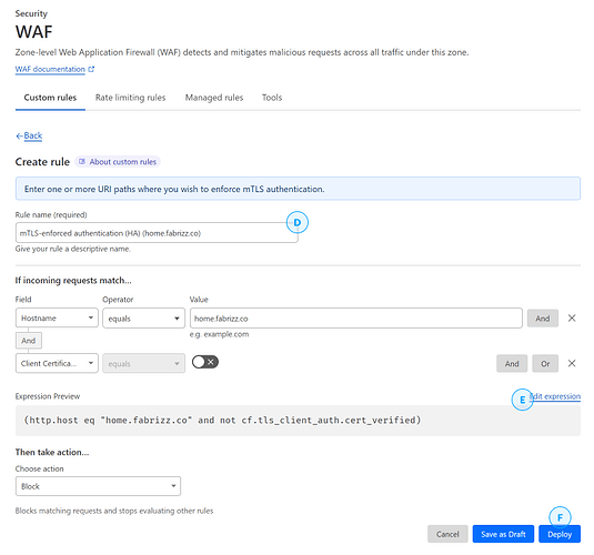

D | Change the name (View image)
Set your WAF rule name to something descriptive, if you use your domain for multiple services or want to have multiple WAF rules, this is important.
E | Creating the rule (View image)
Now we will edit the template included, you can do it using the expression builder, but here we will click (E) Edit expression
and change the default one to:
(http.host eq "home.fabrizz.co" and not cf.tls_client_auth.cert_verified)
Change “home.fabrizz.co” to your subdomain.domain.tld
! (Also make sure that the action is Block
and not Allow
What does this do?
- First it matches the host to your home subdomain.
- Then if the client is NOT tls verified
- Blocks the request to the server
F | Deploying (View image)
Click deploy

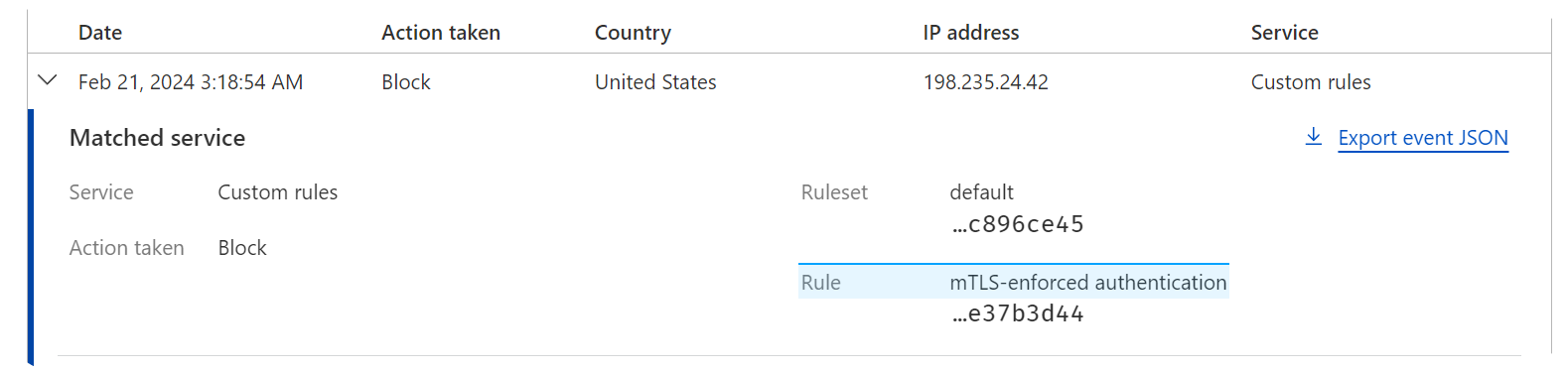

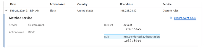

. Now if you go to your HA via the CF tunnel, you should see a Cloudflare page saying that you do not have access to this resource, great!
(Example log when an action is blocked)

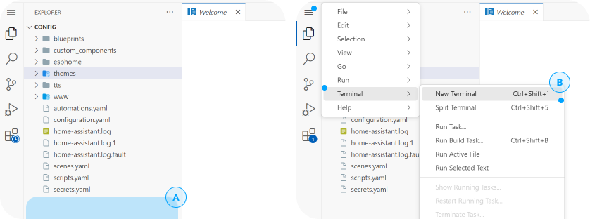

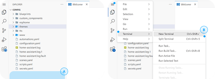

Use Studio Code Server Addon
You should have the addon installed and the web interface open.
- A: Drag and drop your
cert.pem
andkey.pem
files to the config folder - B: Open a new terminal. You should see the Home Assistant welcome screen.
Now you can follow the [general instructions] (https://#general-instructions) on the Home Assistant terminal.
When you finish you can right click on the home_assistant_pkcs12.p12
file and download it to your account, then once you have tested that it works, you can delete this file from Home Assistant using Right click > Delete permanently.
