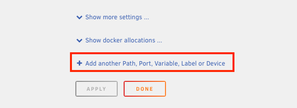

- Edit the Docker container that you wish to connect to Tailscale.

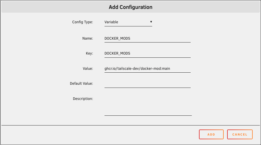

Add a variable:
- Name: DOCKER_MODS
- Key: DOCKER_MODS
- Value:
ghcr.io/tailscale-dev/docker-mod:main

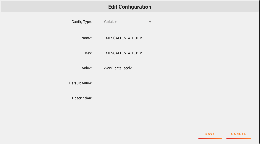

Add a variable:
- Name: TAILSCALE_STATE_DIR
- Key: TAILSCALE_STATE_DIR
- Value:
/var/lib/tailscale

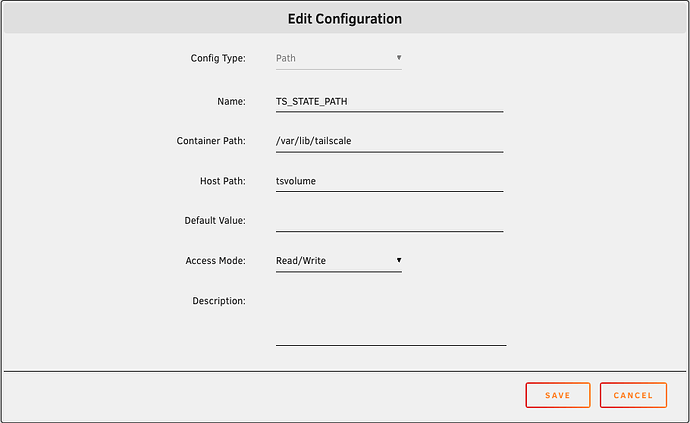

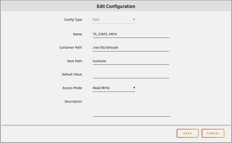

Add a path:
- Name: TS_STATE_PATH
- Container Path:
/var/lib/tailscale
- Host Path: A unique name to create a Docker volume for the Tailscale state.
Note
You can also use a filesystem path to create a bind mount instead of a Docker volume.
Apply the changes to the container.
Warning
If the Tailscale state variable or path are not configured, Tailscale will be logged out any time the container restarts.

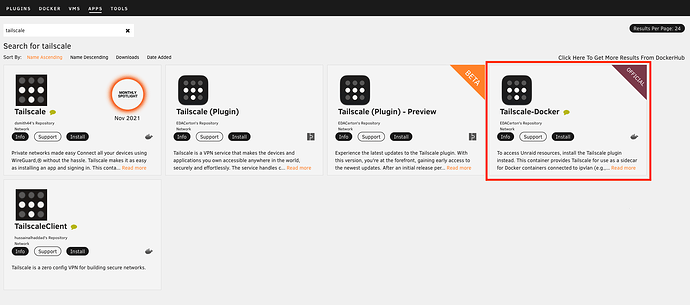

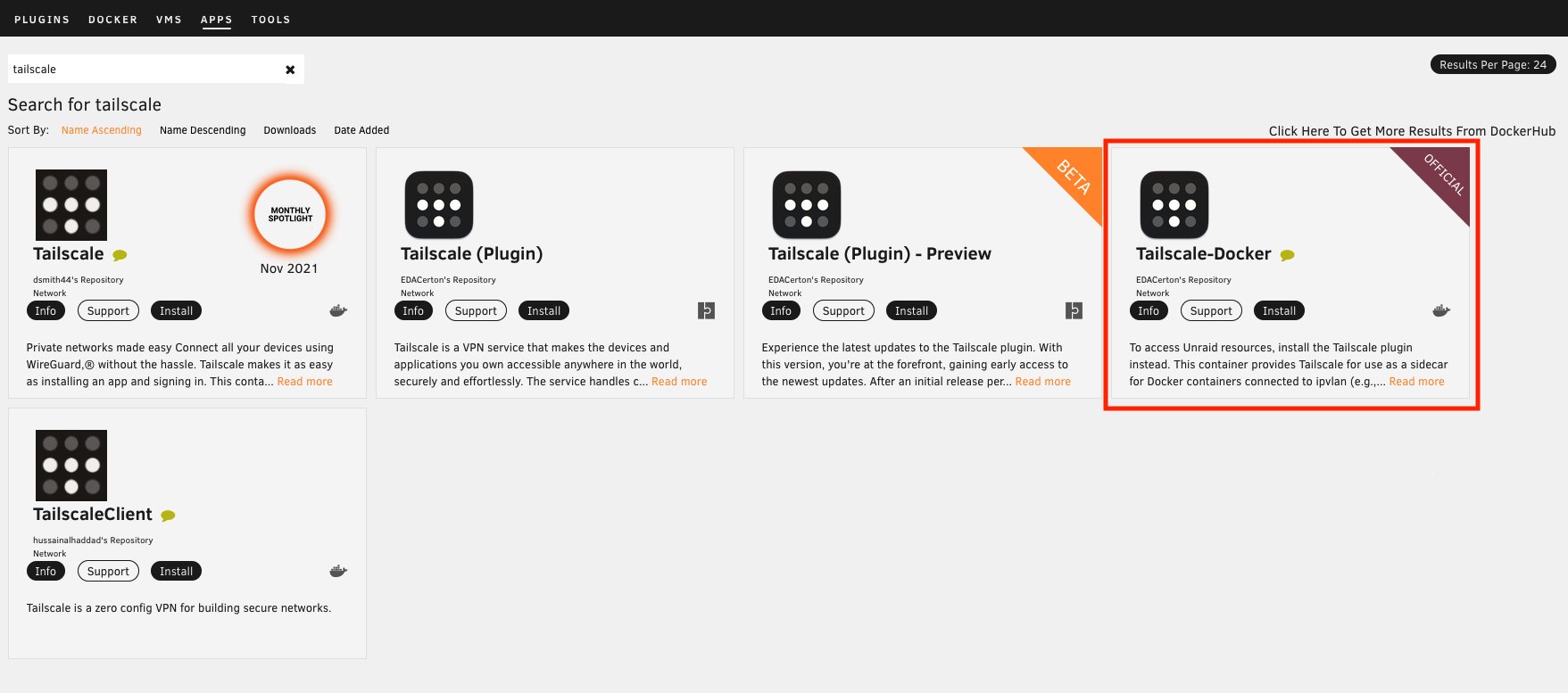

Running Tailscale as a sidecar container¶
Install Tailscale-Docker from Community Applications.

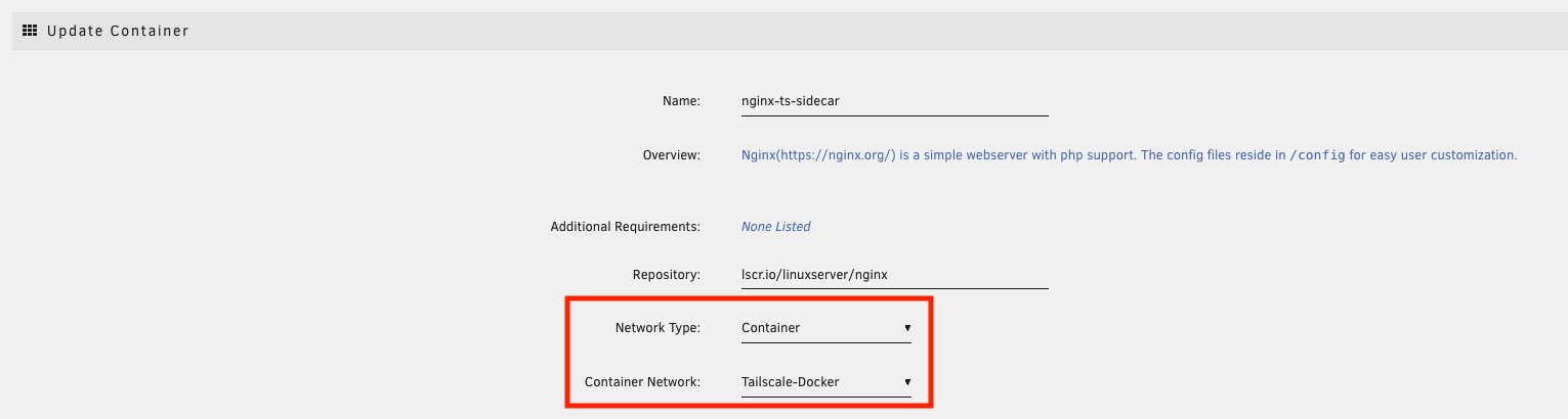

Edit the container that you wish to connect to Tailscale:
Alternate instructions for Unraid 7.0 beta 2 and earlier
The option to connect container networks was added after Unraid 7 beta 2. On earlier versions of Unraid, you can manually configure the connection:
Network Type: None
Extra Parameters:
--net=container:CONTAINERNAME
Network Type: Container
Container Network: The Tailscale container

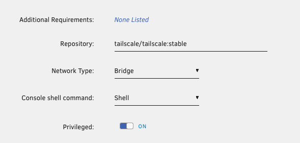

Edit the Tailscale container.
Set Privileged to On.
Expand the settings, then set TS_USERSPACE to
false

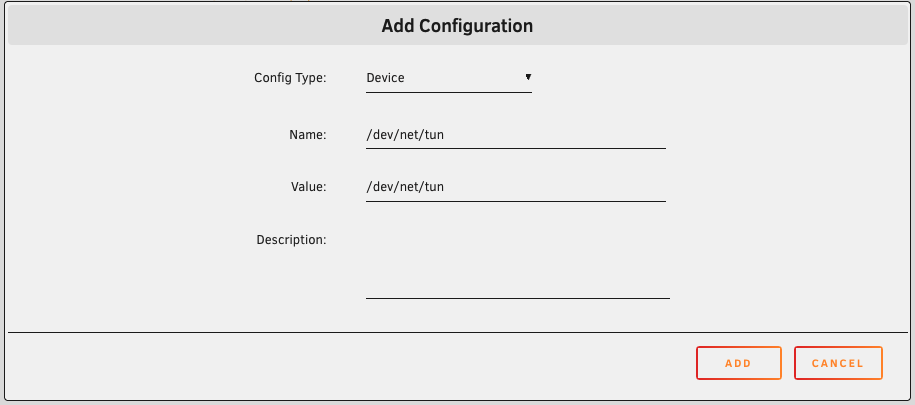

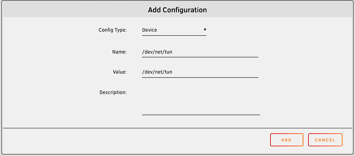

Add a device:
- Name:
/dev/net/tun
- Value:
/dev/net/tun
- Name:
Apply the changes.
