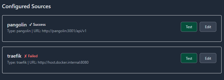

Third
In my middleware-manager dashboard, the data sources are like this. I could not really get the traefik to ever Success. Tried with http://traefik:8080 as suggested, get the same result.
Please advise further and,

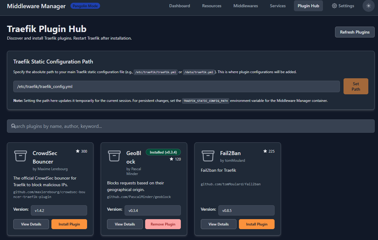

I have a question. In my traefik_config I have:
experimental:
    plugins:
        badger:
            moduleName: github.com/fosrl/badger
            version: v1.2.1
        crowdsec:
            moduleName: github.com/maxlerebourg/crowdsec-bouncer-traefik-plugin
            version: v1.4.6
        geoblock:
            moduleName: github.com/PascalMinder/geoblock
            version: v0.3.4
        traefik-oidc-auth:
            moduleName: github.com/sevensolutions/traefik-oidc-auth
            version: v0.17.0
but in my Traefik Plugin Hub page, only geoblock appears as installed.
Should I press install plugin for the crowdsec bouncer (though it’s already installed I assume.
