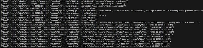

Thanks for the great work! I think I have a middleware bug but I can’t seem to fix it. When I’m in http challenge with middleware-manager I have no errors and everything works but when I try to switch to DNS challenge I get this error
Here is part of my traefik_config.yml file

does resources show in your dashboard in api(dns validation) mode?
I have the same error, as soon as I add the directory: /rules in traefik_config it errors out
“level”:“error”,“entryPointName”:“websecure”,“routerName”:“42-router@http”,“error”:“middleware "crowdsec@file" does not exist”,“time”:“2025-05-30T21:09:40Z”} ││ {“level”:“error”,“entryPointName”:“websecure”,“routerName”:“35-router-auth-auth@file”,“error”:“middleware "crowdsec@file" does not exist”,“time”:“2025-05-30T21:09:40Z”} ││
Thank you very much for this. Until a fix will be found for my specific issue above, I copied the created middleware from the resource-overrides.yml for my services and added them into the dynamic_conf.
All working well, thanks.
All good now.
Issue was the middleware crowdsec@file was throwing errors since crowdsec docker was dead. Now all working good. Thank you.
