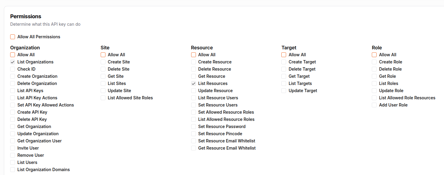

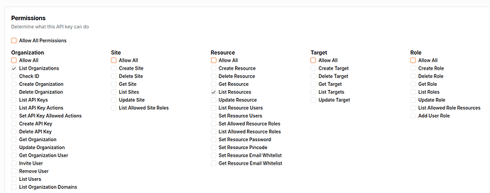

How to Create a Key
  1. Navigate to the appropriate location:
    • Organization → API Keys
  2. Click Create API Key
  3. Give it a descriptive name (testkey)
  4. Select the permissions it needs - we will just use List Organizations and List Resources
The generated key will only be shown once — keep it safe.

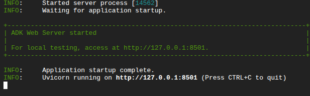

Then install and launch the playground:
cd shadow-it-detector-agent
make install
make playground
you will then see the message

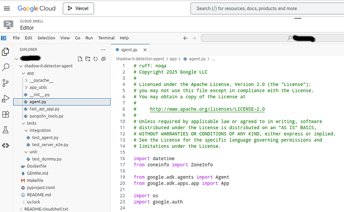

Click on the “Open Editor Button”
Create a file in the same folder as agent.py:
pangolin_tools.py
Paste in the following code:

Step 3 — Update the Agent
In agent.py, import your tools:
from .pangolin_tools import list_organizations, list_organization_resources, set_pangolin_api_key

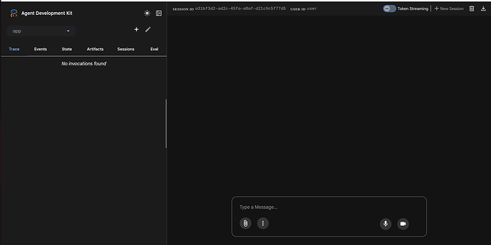

Step 4 — Run the Audit

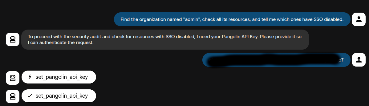

Open the Playground UI and ask:
Find the organization named "admin", check all its resources, and tell me which ones have SSO disabled.

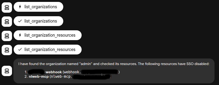

A correct working output looks like:
Here are the resources in the "admin" organization where SSO is disabled:
1. XXXXXX-webhook
   Domain: webhook.example.com
   Status: SSO disabled (resource is publicly accessible)
2. nlweb-mcp
   Domain: nlweb-mcp.example.com
This confirms the Integration API is working, your agent is authenticated, and the audit flow is functioning.
