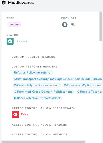

I use middleware-manager V2 and attached custom headers to my nextcloud resource, they are shown on the traefik dashboard, example Strict-Transport-Security: max-age=31536000; includeSubDomains
Nextcloud still tells me they are not set, I checked with dnschecker.org, they seem to be set.
Where is my error?

@hhf.technoloy In the middleware dashboard, I created a new middleware,
named it nextcloud security header
Type is HTTP Header with following content
  "browserXssFilter": true,
  "contentTypeNosniff": true,
  "customFrameOptionsValue": "SAMEORIGIN",
  "customResponseHeaders": {
    "Referrer-Policy": "no-referrer",
    "Strict-Transport-Security": "max-age=31536000; includeSubDomains",
    "X-Content-Type-Options": "nosniff",
    "X-Download-Options": "noopen",
    "X-Permitted-Cross-Domain-Policies": "none",
    "X-Robots-Tag": "none",
    "X-XSS-Protection": "1; mode=block"
I attached this middleware within the mwm dashboard to my existing pangolin resource.

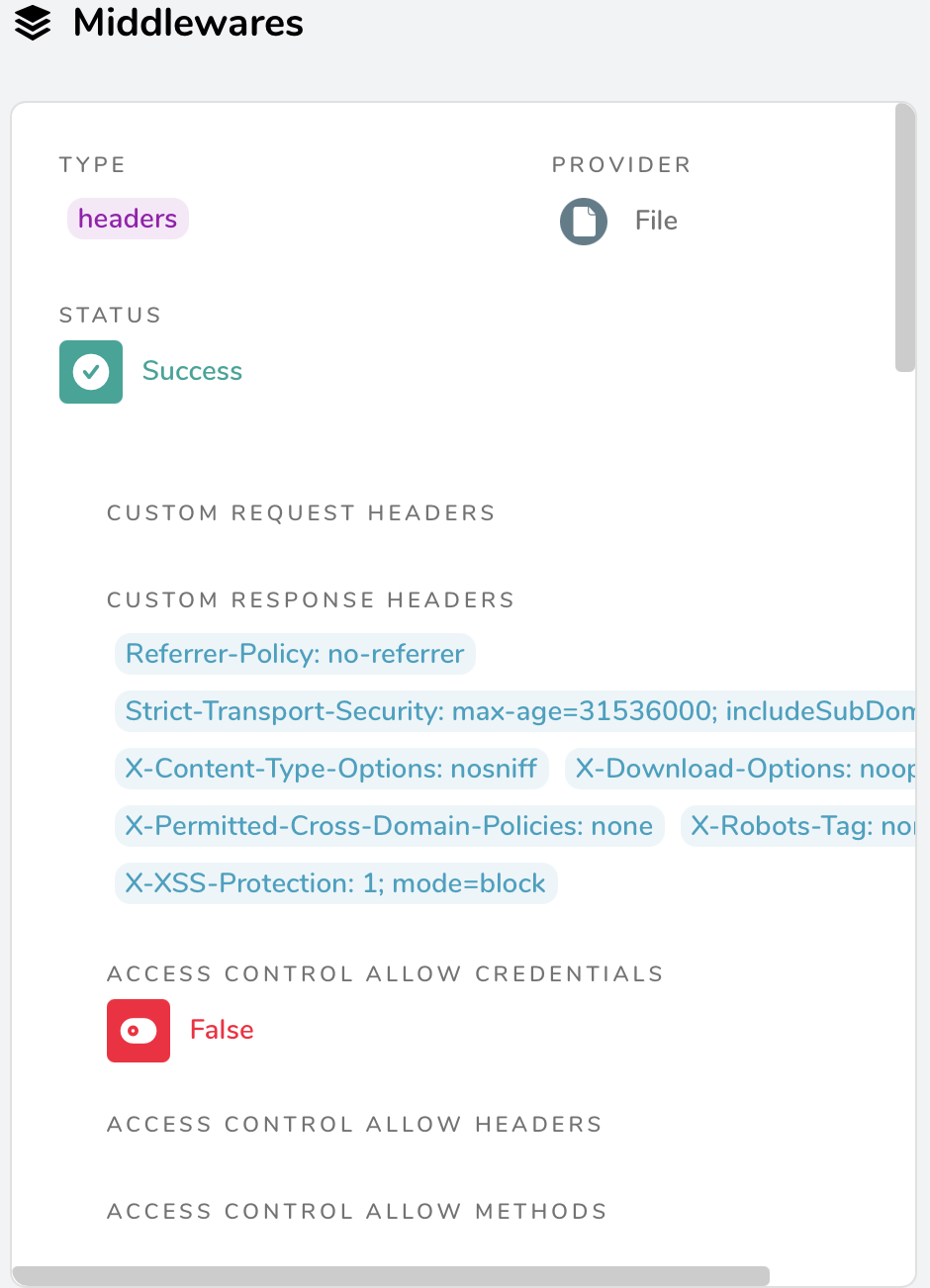

Checked the traefik dashboard under routers
any idea what I am doing wrong
headers are working and the middleware manager is also as you can see them in the traefik dashboard. why nextcloud is not taking :person_shrugging:
thank you for your look, so I know this configuration is ok. This is one step in the right direction.
Now I have to figure out what I did wrong on the nextcloud.
