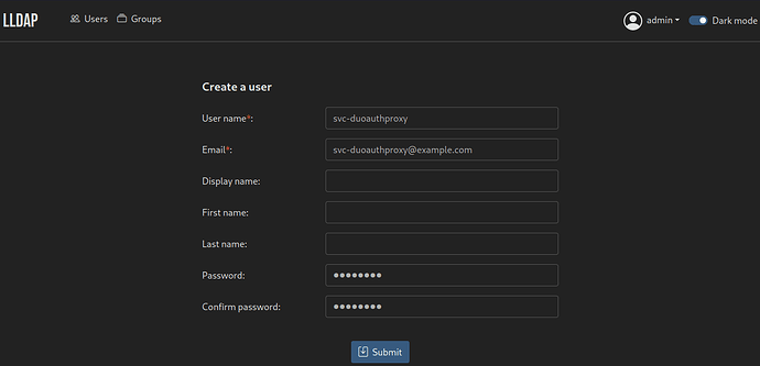

Configuring LLDAP

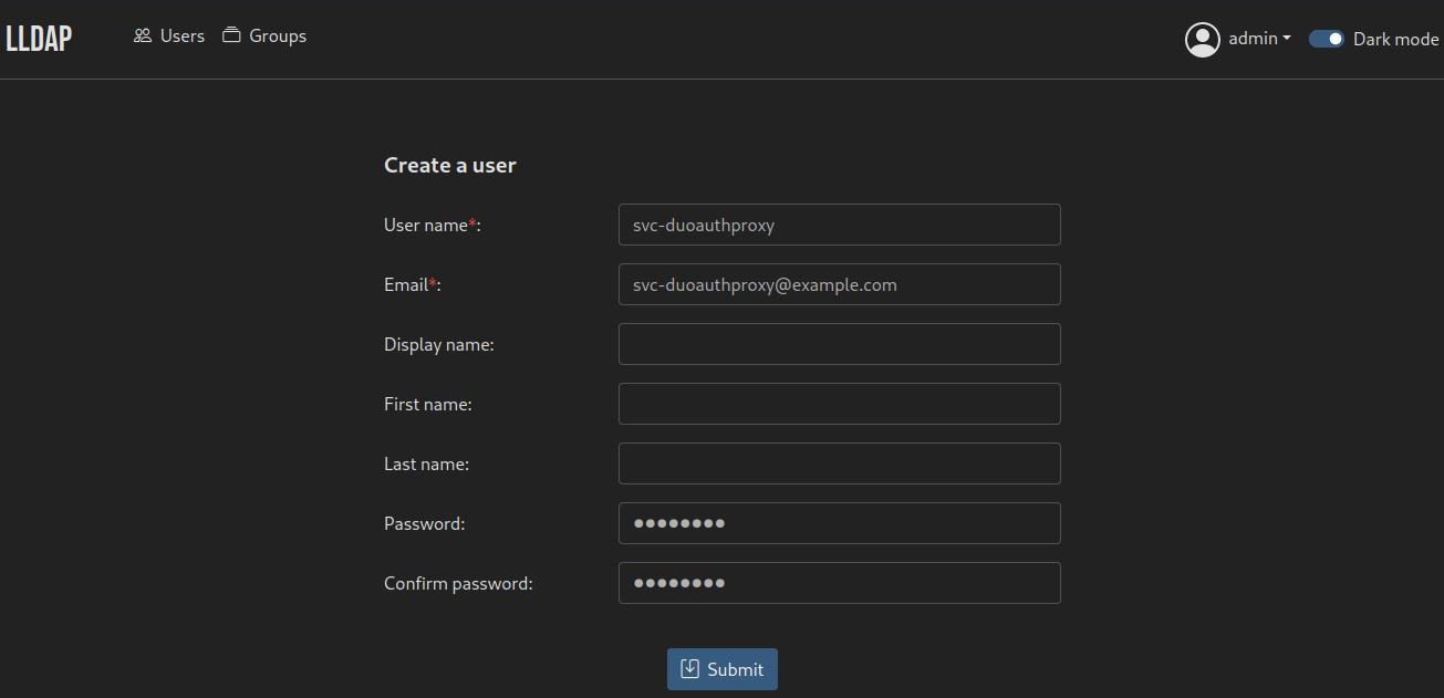

Visit the frontend at port 17170 and create a service user for DuoAuthProxy accordingly, you can replace the values if needed.
For the sake of this example, the password of the svc-duoauthproxy user is `password`

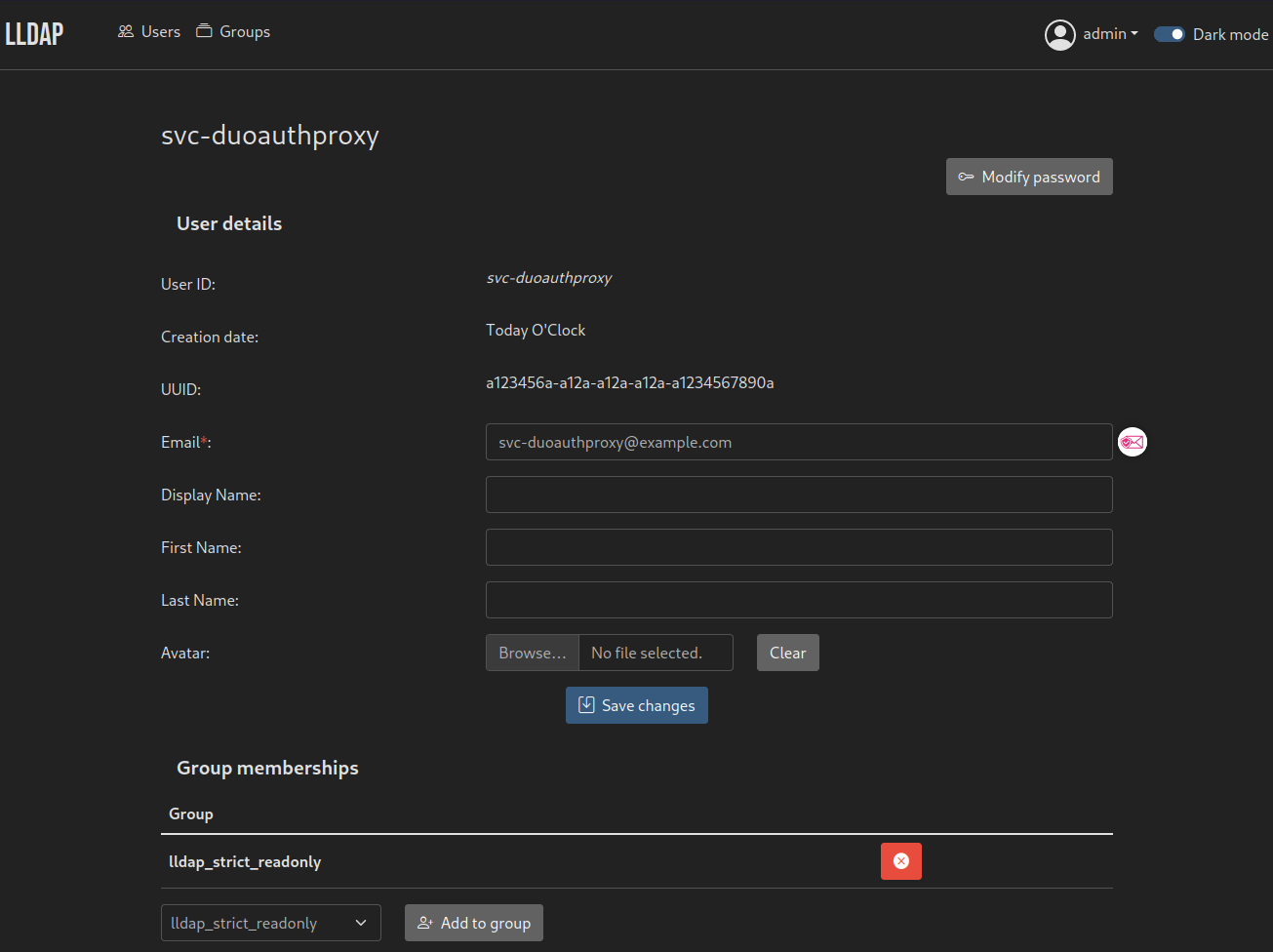

Make sure to add the user to either lldap_strict_readonly (read-only) or lldap_password_manager (allow password change on Jellyfin) groups

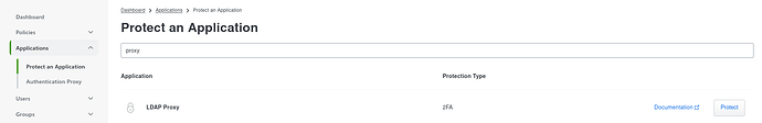

Go to Applications → Protect an Application
Search for `proxy` and protect an `LDAP Proxy` application

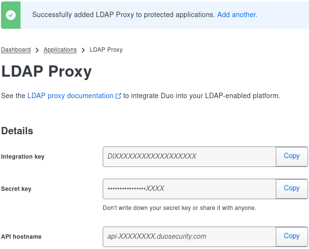

Copy the credentials to prepare for the next step

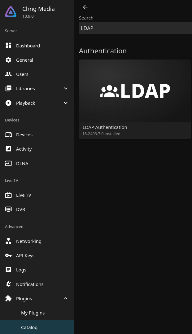

Preparing Jellyfin
I would assume you would already have Jellyfin set up, add Jellyfin to the auth network by re-running the container while adding `–network auth` argument to the docker run
Installing LDAP Authentication Jellyfin Plugin
Note: I’m currently using the unstable version of Jellyfin (10.9.0) as of posting, I had to use the unstable plugins repository.
Please be reminded to restart Jellyfin after installing the plugin.

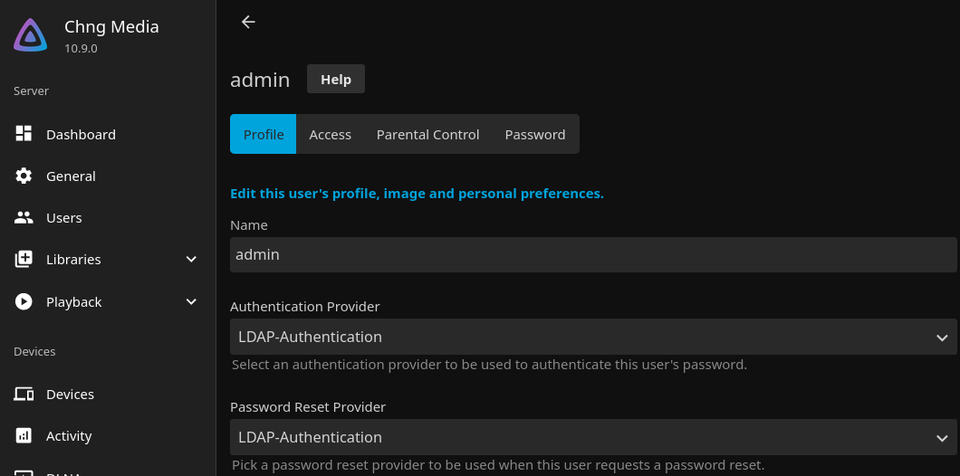

(If Jellyfin has existing users) Switch users’ Authentication Provider to LDAP-Authentication
