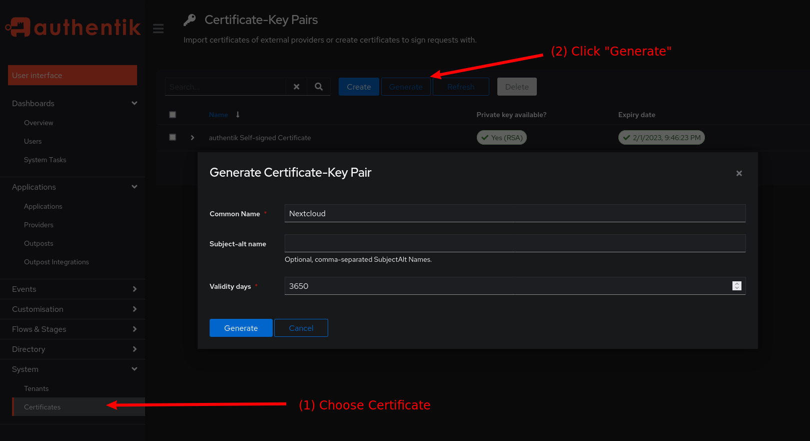

On the Authentik dashboard, click on System and then Certificates in the left sidebar. There, click the Generate button to create a new certificate and private key. As a Name simply use Nextcloud and for the validity use 3650 days. Then, click the blue Generate button. Afterwards, download the Certificate and Private Key of the newly generated key-pair. Also download the Certificate of the (already existing) authentik self-signed certificate (we will need these later).

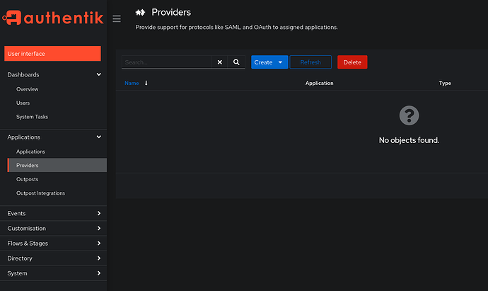

Next, click on Providers in the Applications Section in left sidebar. Click the blue Create button and choose “SAML Provider”

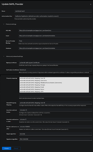

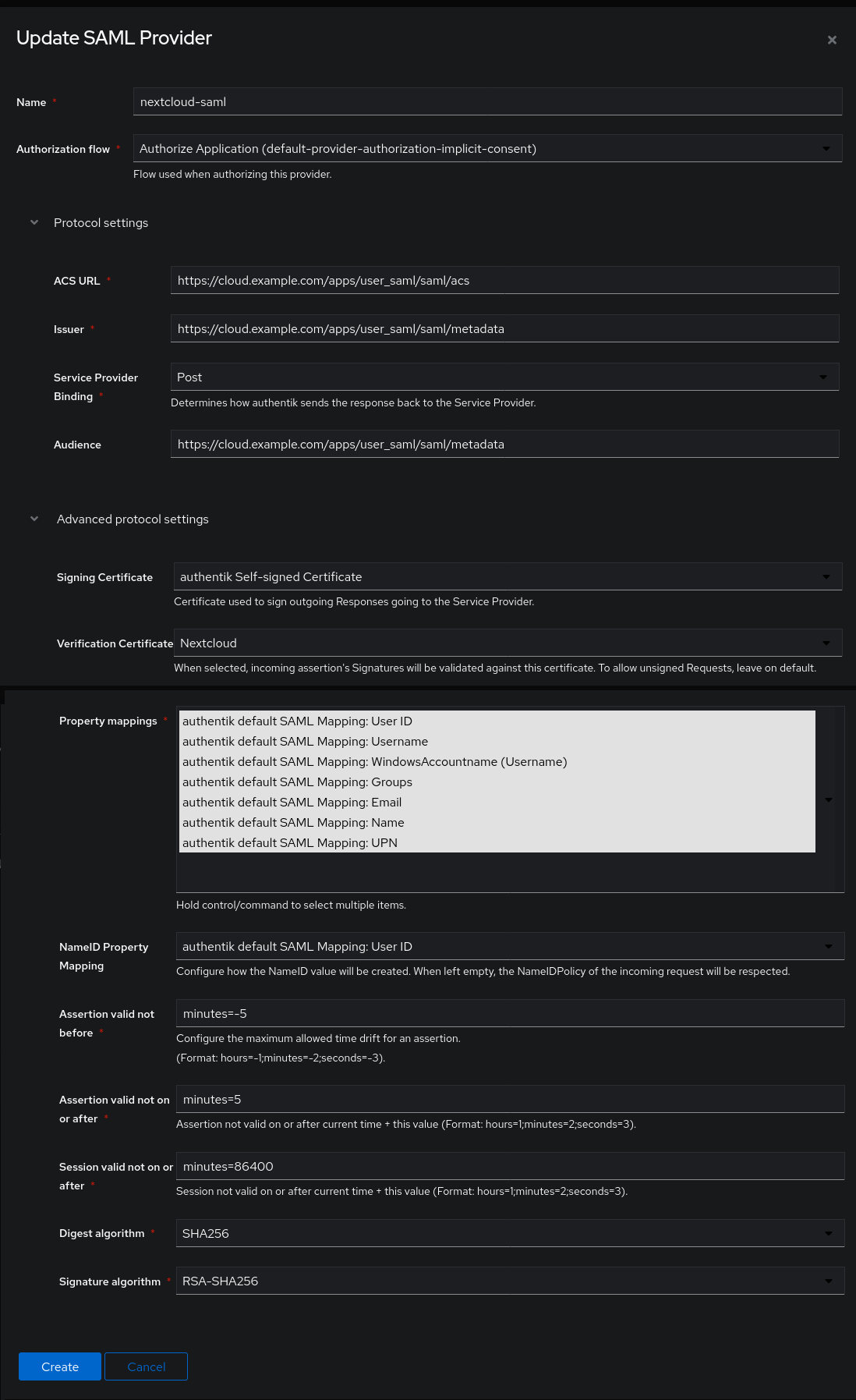

To configure the SAML provider, use the following settings:
- Name:
nextcloud-saml - Authorization flow: choose the
implicitorexplicitauthorization. Explicit means the users will be asked wether they want to give their username and email address to Nextcloud before logging in, with implicit they won’t get asked. - ACS URL:
https://cloud.example.com/apps/user_saml/saml/acs - Issuer:
https://cloud.example.com/apps/user_saml/saml/metadata[1] - Service Provider Binding:
POST - Audience:
https://cloud.example.com/apps/user_saml/saml/metadata - Signing certificate:
authentik self-signed certificate - Verification certificate:
Nextcloud - Property mappings: select all entries (default)
- NameID Property mapping:
User ID - the rest of the fields you can leave as they are
Don’t forget to click the blue Create button at the bottom. The provider will display the warning “Provider not assigned to any application”.
[1] This might seem a little strange, since logically the issuer should be Authentik (not Nextcloud). However, when setting any other value for this configuration, I received the following error:
Invalid issuer in the Assertion/Response (expected 'https://cloud.example.com/apps/user_saml/saml/metadata', got 'https://auth.example.com')
Here is the full configuration of the new Authentik Provider:

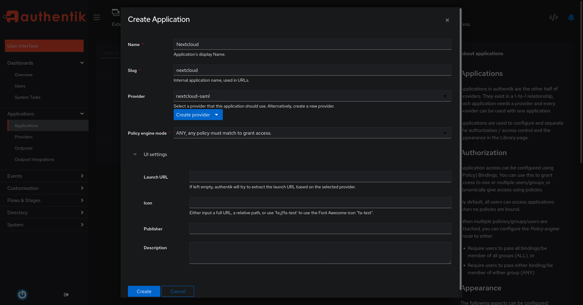

Finally, we are going to create an Application in Authentik. Click on Applications in the left sidebar and then click on the blue Create button. Use the following settings:
- Name:
Nextcloud - Slug:
nextcloud(do not change this, otherwise the following settings won’t work!) - Provider:
nextcloud-saml(this must match the name of your Provider)
Again, click Create at the bottom.

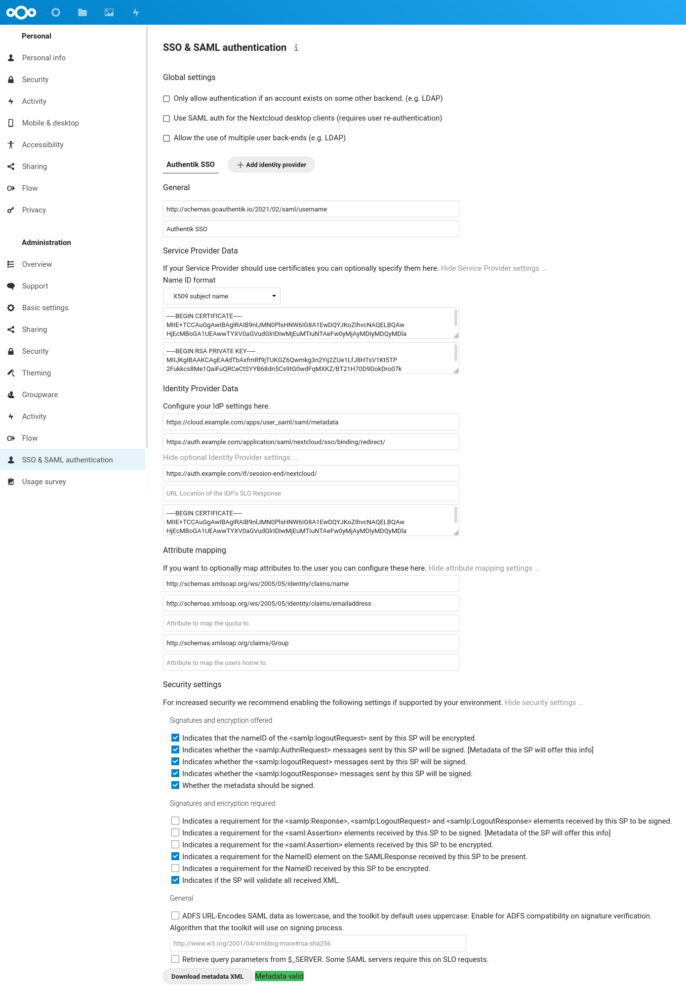

After that’s done, click on your user account symbol again and choose “Settings”. Locate the SSO & SAML authentication section in the left sidebar.
Nextcloud SAML Configuration
Use the following settings (notice that you can expand several sections by clicking on the gray text):
- General
- Attribute to map UID to:
http://schemas.goauthentik.io/2021/02/saml/username - Display name of Identity Provider:
Authentik SSO - Service Provider Data
- Choose
X509 subject nameand insert theNextcloudcertificate and private key you downloaded from Authentik (the one that was generated) - Identity Provider Data
- Identifier of the IdP:
https://cloud.example.com/apps/user_saml/saml/metadata - URL Target of the IdP where the SP will send the Authentication Request Message:
https://auth.example.com/application/saml/nextcloud/sso/binding/redirect/ - URL Location of IdP where the SP will send the SLO Request:
https://auth.example.com/if/session-end/nextcloud/ - URL Location of SLO Response: (empty)
- Public X.509 certificate of the IdP: insert the certificate you downloaded from
authentik self-signed certificate - Attribute mapping
- Attribute to map the displayname to:
http://schemas.xmlsoap.org/ws/2005/05/identity/claims/name - Attribute to map the email address to:
http://schemas.xmlsoap.org/ws/2005/05/identity/claims/emailaddress - Attribute to map the users groups to:
http://schemas.xmlsoap.org/claims/Group - Security settings
- Indicates that the nameID of the samlp:logoutRequest sent by this SP will be encrypted.
- Indicates whether the samlp:AuthnRequest messages sent by this SP will be signed.
- Indicates whether the samlp:logoutRequest messages sent by this SP will be signed.
- Indicates whether the samlp:logoutResponse messages sent by this SP will be signed.
- Whether the metadata should be signed.
- Indicates a requirement for the samlp:Response, samlp:LogoutRequest and samlp:LogoutResponse elements received by this SP to be signed.
- Indicates a requirement for the saml:Assertion elements received by this SP to be signed.
- Indicates a requirement for the saml:Assertion elements received by this SP to be encrypted.
- Indicates a requirement for the NameID element on the SAMLResponse received by this SP to be present.
- Indicates a requirement for the NameID received by this SP to be encrypted.
- Indicates if the SP will validate all received XML.
Finally, after you entered all these settings, a green Metadata valid box should appear at the bottom. Note that there is no Save button, Nextcloud automatically saves these settings.
I would have liked to enable also the lower half of the security settings. These require that the assertion sent from the IdP (Authentik) to the SP (Nextcloud) is signed / encrypted with a private key. Unfortunately, I could not get this working, since I always got the following error messages (depending on the exact setting):
The Message of the Response is not signed and the SP requires it
The Message of the Response is not encrypted and the SP requires it
No InResponseTo at the Response, but it was provided the requestId related to the AuthNRequest sent by the SP: ONELOGIN_bf5cc45cd77bd413aa3d334f79a2f41c05d43ff8
If anyone has an idea how to resolve this, I’d be happy to try it out and update this post.
