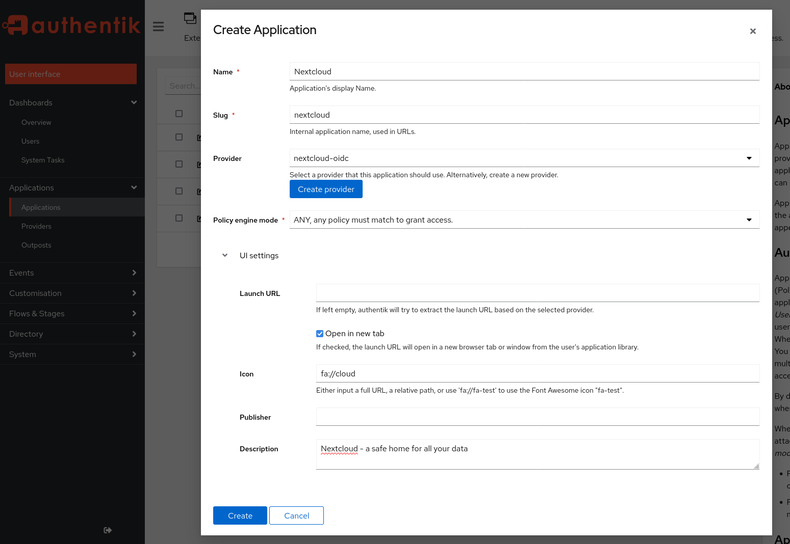

Since OIDC describes a trust relationship between the identity provider (Authentik) and the relying party (Nextcloud), we need to let Authentik know about the new application it should handle authentication for. To do this, log into your Authentik instance as an administrator and switch to the “Admin interface” (the button in the top-right corner). Go to the Applications menu and click on Create:
Authentik ‘Application’ Creation Menu

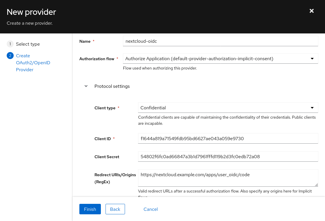

Click on the Create Provider button and fill the menu (shown below) with following settings:
  • Type: Oauth2/OIDC Provider
  • Authorization flow: implicit consent (otherwise your users need to confirm each login explicitly!)
  • Client type: Confidential
  • Client ID: (leave auto-generated value as-is)
    • => copy this value for later use
  • Client Secret: [IMPORTANT] trim the auto-generated value to 64 characters - there is currently a bug in user_oidc that prevents longer client secrets. A client secret of 64 chars is still sufficient from a security perspective.
  • Redirect URIs: https://<NEXTCLOUD-HOSTNAME>/apps/user_oidc/code
  • Advanced protocol settings > Subject mode: based on the username
    • this setting should be used to ensure Nextcloud’s federated cloud ID will have a human-readable value, like username@nextcloud-hostname.com.
  • Click on Finish
Authentik ‘Provider’ Creation Menu
Back in the application creation menu, click on Create.

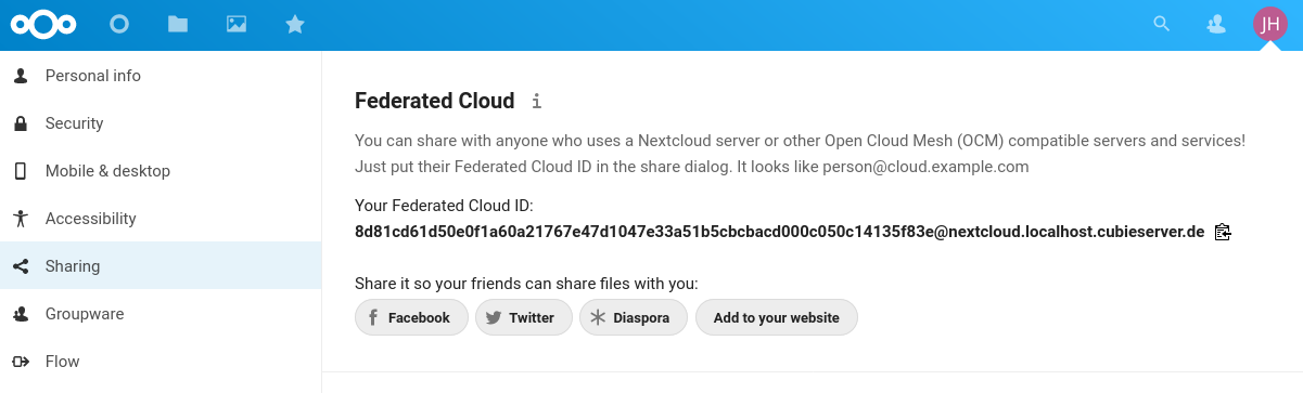

  • Uncheck Use unique user ID - when this option is enabled, Nextcloud will use the hash (checksum) of the provider identifier + user identifier as the internal user ID. Unfortunately, this creates rather ugly and long federated cloud IDs. Unless you are using multiple OIDC providers or multiple Nextcloud user backends, I believe it’s safe to disable (untick) this option, since there can be no name collision within a single OIDC provider.

A long federated cloud ID caused by the ‘Use unique user ID’ setting

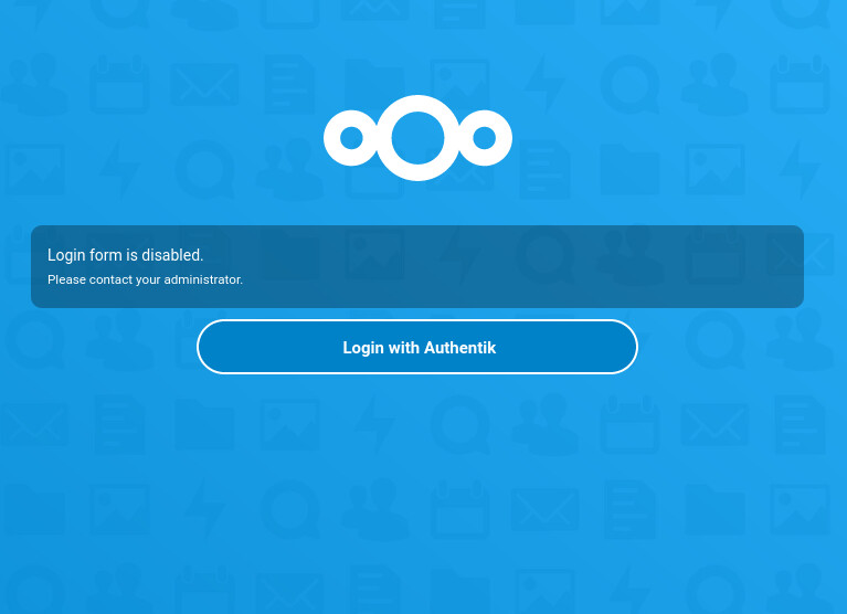

  • 1: disabling the built-in login form by setting 'hide_login_form' => false in the config.php (see Nextcloud documentation). This will show a slightly ugly warning message on the login page, but at least it’s clear for users that they need to click on the Login with X button. The login form is just hidden, because it can still be accessed at https://<NEXTCLOUD-HOSTNAME>/login?direct=1 - this is required when you want to access Nextcloud with your local admin account.
Nextcloud with disabled login form

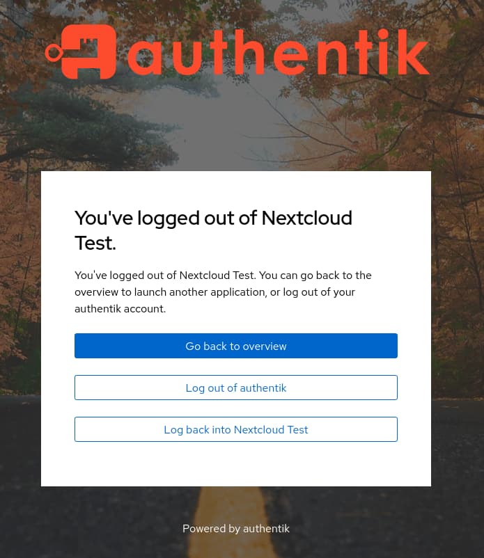

The first one is single logout: if this option is enabled (which it is by default), the user is also logged out of the entire SSO session (instead of just Nextcloud). However, Authentik will still ask the user if they want to log out of their SSO session, therefore we can leave this setting as-is.
​Single logout is enabled, but Authentik still asks if the user want to end all SSO sessions
