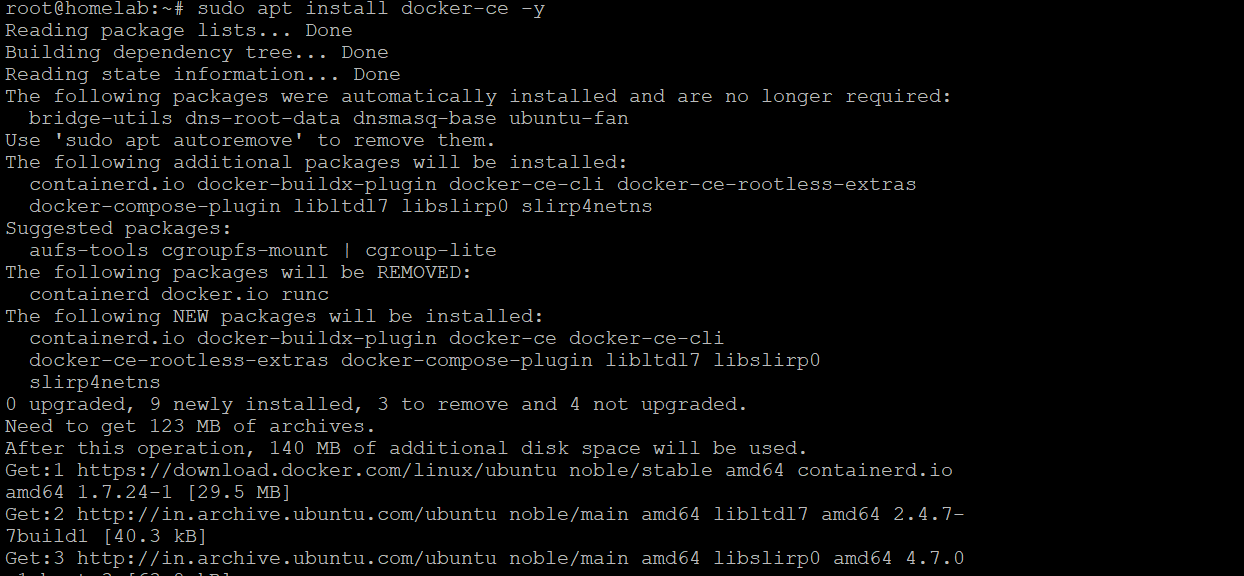

  1. Install Docker CE (Community Edition):
sudo apt install -y docker-ce docker-ce-cli containerd.io docker-buildx-plugin docker-compose-plugin

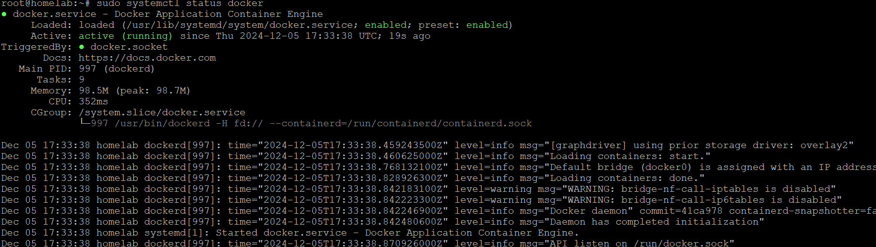

  1. Check Docker service status:
sudo systemctl status docker
