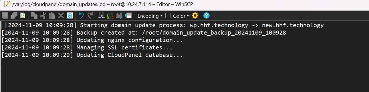

  2. Logging System:
    • Added timestamp-based logging
    • Logs are written to both console and log file
    • Maintains audit trail of all domain updates

  • Log all actions
  • Provide detailed feedback about the process
Logs can be found at /var/log/cloudpanel/domain_updates.log for audit purposes.
