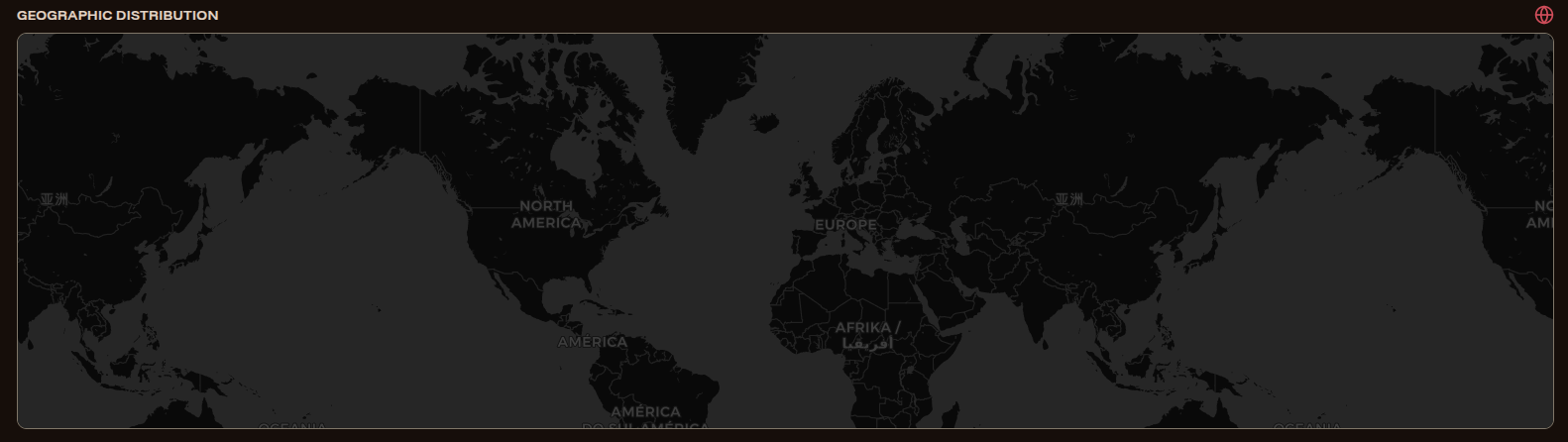

Description
CARTO changed their policy around 28 Aug 2026: anonymous (keyless) requests to their free basemap tile endpoints (basemaps.cartocdn.com) now return tiles stamped with a large “API KEY REQUIRED” watermark instead of clean tiles. This affects the “Geographic Distribution” map card on the dashboard, which pulls its basemap from CARTO without a key.
The underlying data (pins, total locations, total requests) still works fine. It’s purely a cosmetic/branding issue on the map tiles themselves.
Steps to reproduce
  1. Open the dashboard
  2. Go to the Geographic Distribution view
  3. Map tiles render with diagonal “API KEY REQUIRED Get your CARTO Basemaps API key | CARTO” watermarks over Europe, Africa, South America, etc.
Expected behavior
Clean basemap tiles with no watermark.
Suggested fix
CARTO now requires a free API key (no account needed, ~1 min signup at Get your CARTO Basemaps API key | CARTO) appended to tile requests as a query param, e.g.:
https://{s}.basemaps.cartocdn.com/rastertiles/voyager/{z}/{x}/{y}{r}.png?key=YOUR_KEY
Could you add an env var (e.g. PUBLIC_CARTO_API_KEY) that gets appended to the tile URL in the map component if set, similar to how other projects (Home Assistant cards) have patched this? Leaving it unset could keep the current behavior (watermarked but working) for backward compatibility.

matthabjan commented on GitHub:
I’ve opened #234 to fix this. It switches the default basemap to OpenFreeMap. OpenFreeMap needs no API key and no sign-up, and has no request limits, so the map works again without any setup. It uses vector tiles, with light and dark styles close to the old CARTO ones.
The basemap can now also be set with environment variables, without rebuilding the image:
  • DASHBOARD_MAP_TILE_URL / DASHBOARD_MAP_TILE_URL_DARK: a raster tile URL (https://…/{z}/{x}/{y}.png) or a MapLibre style URL
  • DASHBOARD_MAP_TILE_ATTRIBUTION: the credit shown on the map
If you have a CARTO key and want to keep CARTO, put the key in the URL:
environment:
  - DASHBOARD_MAP_TILE_URL=https://{s}.basemaps.cartocdn.com/light_all/{z}/{x}/{y}.png?key=YOUR_KEY
  - DASHBOARD_MAP_TILE_URL_DARK=https://{s}.basemaps.cartocdn.com/dark_all/{z}/{x}/{y}.png?key=YOUR_KEY
  - DASHBOARD_MAP_TILE_ATTRIBUTION=&copy; OpenStreetMap contributors &copy; CARTO
OpenStreetMap’s raster tiles work the same way, with https://tile.openstreetmap.org/{z}/{x}/{y}.png. That replaces the sed workaround above.
