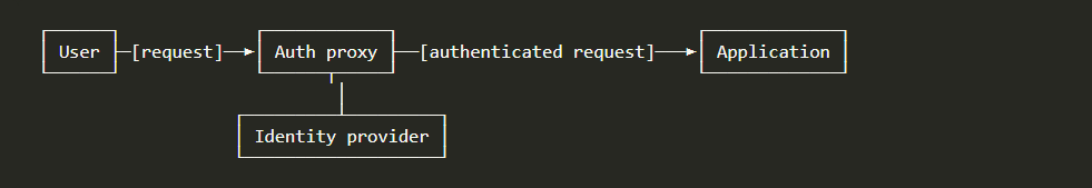

Many web applications these days support some form of centralized user management (LDAP, OAuth2/OIDC, SAML …). For those that don’t a special type of reverse proxy can be installed “in front of” the application to handle user authentication. This authentication proxy makes sure all HTTP requests coming from outside are authenticated and only authenticated requests are forwarded to the application. It completely removes the need for the application to integrate with native authorization and authentication protocols - which can be a daunting task and challenging to do correctly! Instead the application just needs to look at HTTP headers to determine the properties of the authenticated user: name, groups, roles etc.
A popular open-source project that implements this concept is OAuth2 Proxy. Fortunately, Authentik already comes with an “embedded” authentication proxy, therefore it is not necessary to set up a separate instance of the reverse proxy - handy!
In this post I want to document how to set up such an authentication proxy with Authentik Identity Provider and Traefik Proxy, since I’m sure I’ll be using this more often in the future, thus it might be useful for you, too. The setup is also described in the Authentik documentation (referred to as forward authentication), although very terse and without much context.

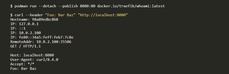

For testing purposes we’ll use the whoami server: it returns all received HTTP headers as the body of the response plus some additional metadata, like this:

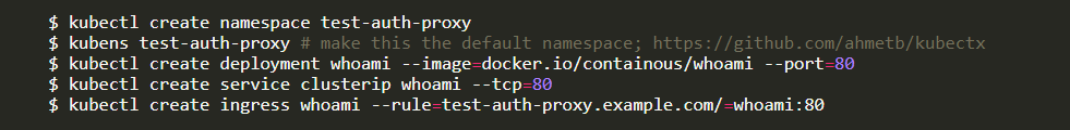

Create Kubernetes Deployment, Service and Ingress resources in a new namespace:

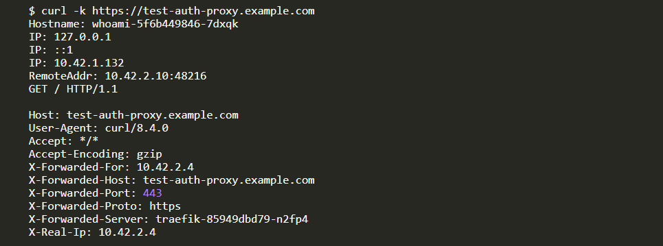

Assuming that the cluster has functional external DNS and an ingress controller, the application should now be available at test-auth-proxy.example.com:
We can see that the HTTP request was routed through Traefik before reaching the whoami application, since Traefik injects various X-Forwarded-* headers.
