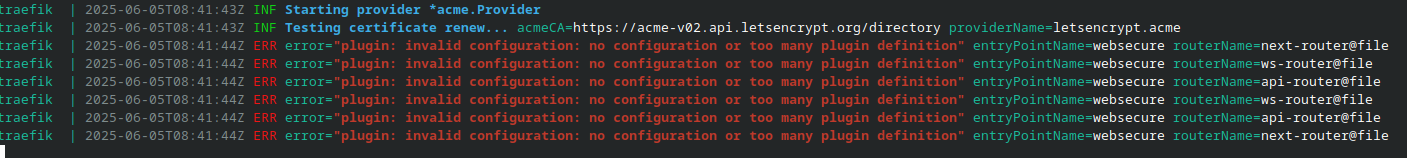

Good morning. I followed the the tutorial but get the same error as the other user :
"plugin":"plugin-geoblock","module":"github.com/david-garcia-garcia/traefik-geoblock","runtime":"","time":"2025-05-10T00:09:40Z","level":"error","message":"2025/05/10 00:09:40 time=2025-05-10T00:09:40.579Z level=ERROR msg=\"could not find file\" plugin=geoblock@file file=IP2LOCATION-LITE-DB1.IPV6.BIN path=/plugins-storage/IP2LOCATION-LITE-DB1.IPV6.BIN\n"}
{"level":"error","entryPointName":"websecure","routerName":"ws-router@file","error":"geoblock@file: failed to open database: open /plugins-storage/IP2LOCATION-LITE-DB1.IPV6.BIN: no such file or directory","time":"2025-05-10T00:09:40Z"}
Where is the location of the folder I have to copy the .BIN file? I’m a bit new to linux and Docker. I don’t see a folder named plugins-local in /home/ubuntu/config/traefik where the other files I needed to edit are.
Thanks!

I had the same problem.
When you edit the docker-compose file to add a volume, you can’t just restart traefik; you have to use :
docker compose down && docker compose up -d
