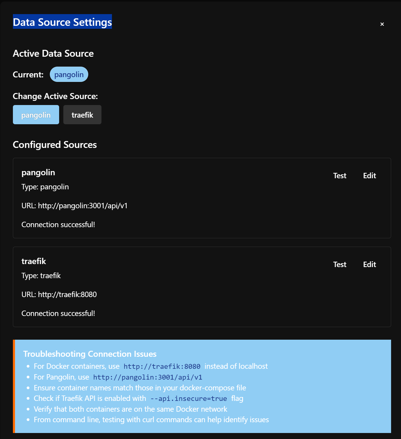

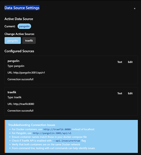

noticed something today in the settings probably didn’t caught my attention. I saw Data Source Settings and its set for pangolin. What happens if I switched to traefik? will that cause an issue or would it be better to switch?
yes. if using pangolin don’t. it will confuse you. pangolin part is working flawsley. it’s for general use if you are not with pangolin.

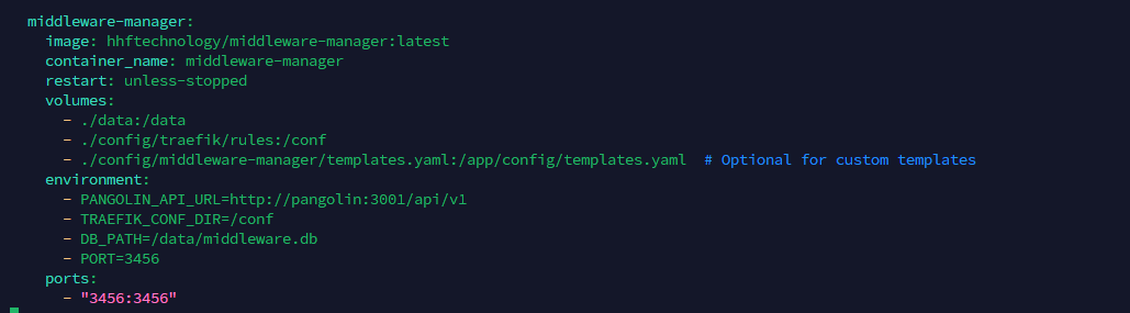

It looks like it thinks templates.yaml is a directory.
Here is the relevant section of the docker compose file.
you will have to create the yml file first.
what needs to go in the file?
choose what’s needed and deploy
alright. That seemed to work.

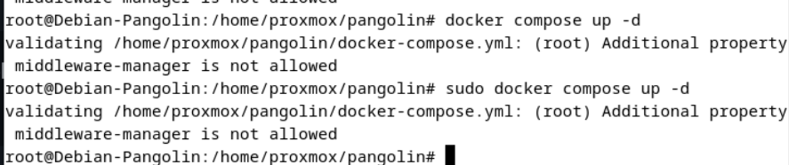

When I try it with those I now at least get a new error :stuck_out_tongue:
(root) additional property middleware-manager is not allowed
just use docker compose up -d
Even with that it says the same.
its yml indentation error.

Ah right! I always forgets that. So what now if I’ve removed the tabs from the updates I did (went back, and checked which files was altered, then removed tabs and added spaces instead).
Error remains.

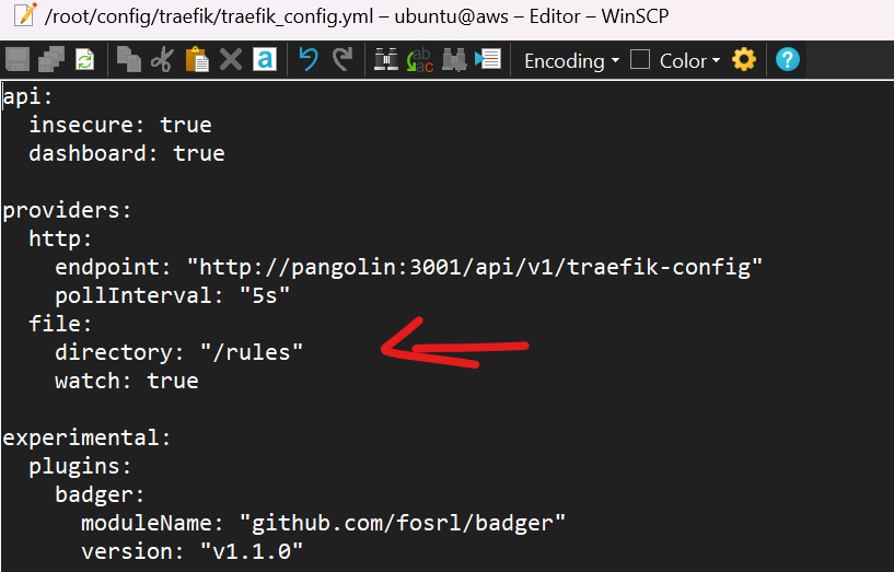

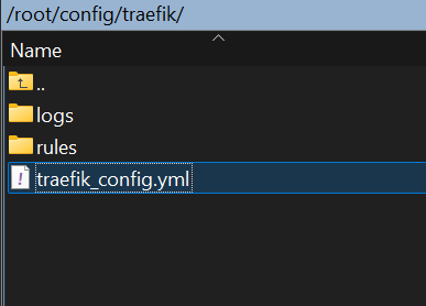

Hi, there are two ways you can access middleware manager. on by making, it a resource and other by directly putting it as router and service in the dynamic file.
I am sure you have not update traefik_config.yml file with correct paths.
you have to move dynamic file in to rules folder.
then
Check you compose file

correct and set similar like what i have shown in screenshot.
api:
  insecure: true
  dashboard: true
providers:
  http:
    endpoint: "http://pangolin:3001/api/v1/traefik-config"
    pollInterval: "5s"
  file:
    directory: "/rules"
    watch: true
experimental:
  plugins:
    badger:
      moduleName: "github.com/fosrl/badger"
      version: "v1.1.0"
log:
  level: "INFO"
  format: "common"
certificatesResolvers:
  letsencrypt:
    acme:
      httpChallenge:
        entryPoint: web
      email: "discourse@hhf.technology"
      storage: "/letsencrypt/acme.json"
      caServer: "https://acme-v02.api.letsencrypt.org/directory"
entryPoints:
  web:
    address: ":80"
  websecure:
    address: ":443"
    transport:
      respondingTimeouts:
        readTimeout: "30m"
    http:
      tls:
        certResolver: "letsencrypt"
serversTransport:
  insecureSkipVerify: true
